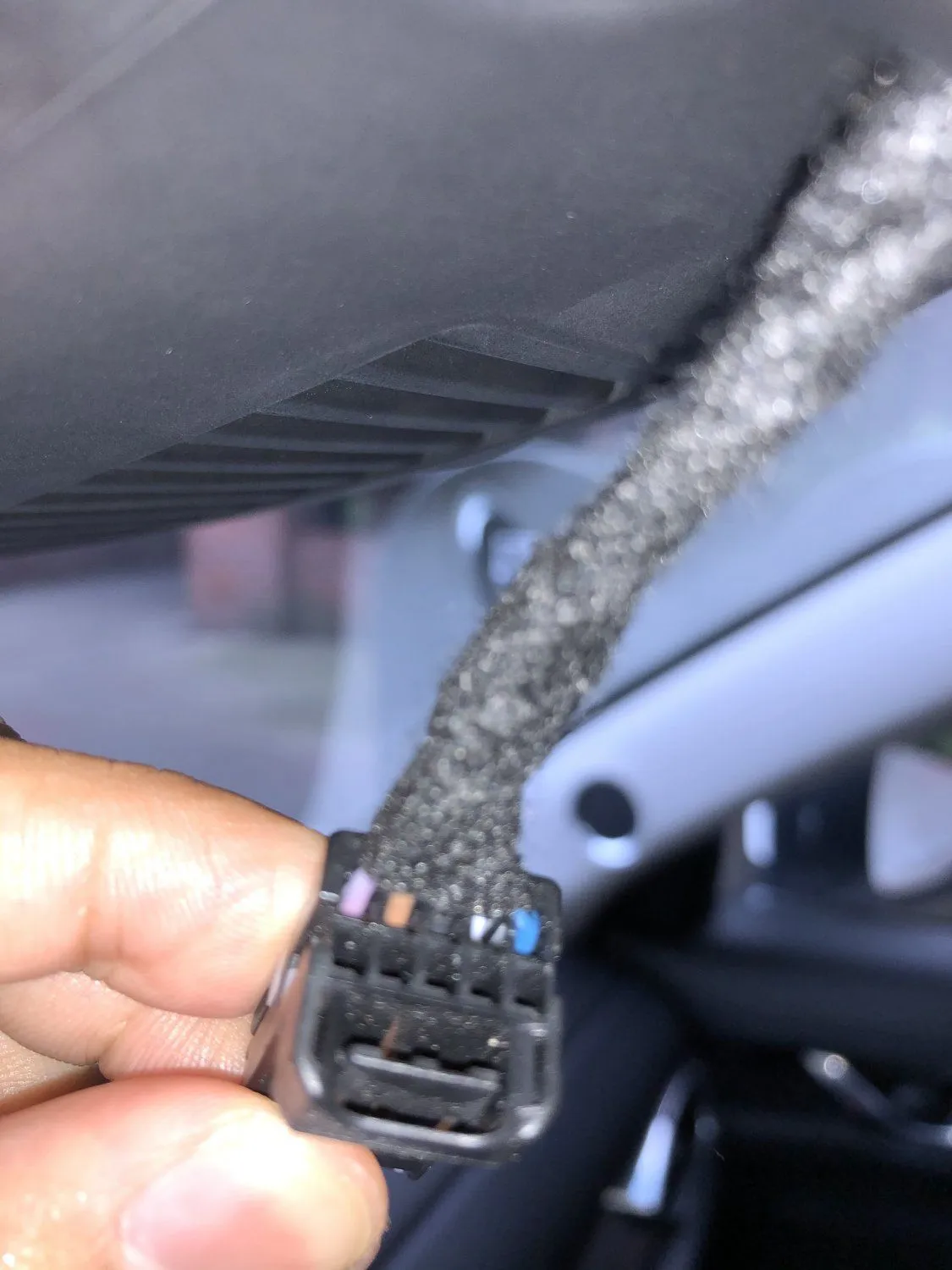

What I've learned is that all you need is a power and ground, but you need to be aware of whether the power is always on or ignition on only. I do worry about always-on in the mirror, because I think the Home Link feature might use it, and obviously always-on with a dashcam will drain and ruin your battery unless protected.
I also gather that these work by plugging a wire into the backside of the connector, basically piggy backing (pig tailing?) into the wire coming from the chassis. This is different from my original, bad guess that they simply inserted a y-connector using compatible sockets. The advantage of the MirrorTap for this purpose is that you get to pick the wire with the best fit.

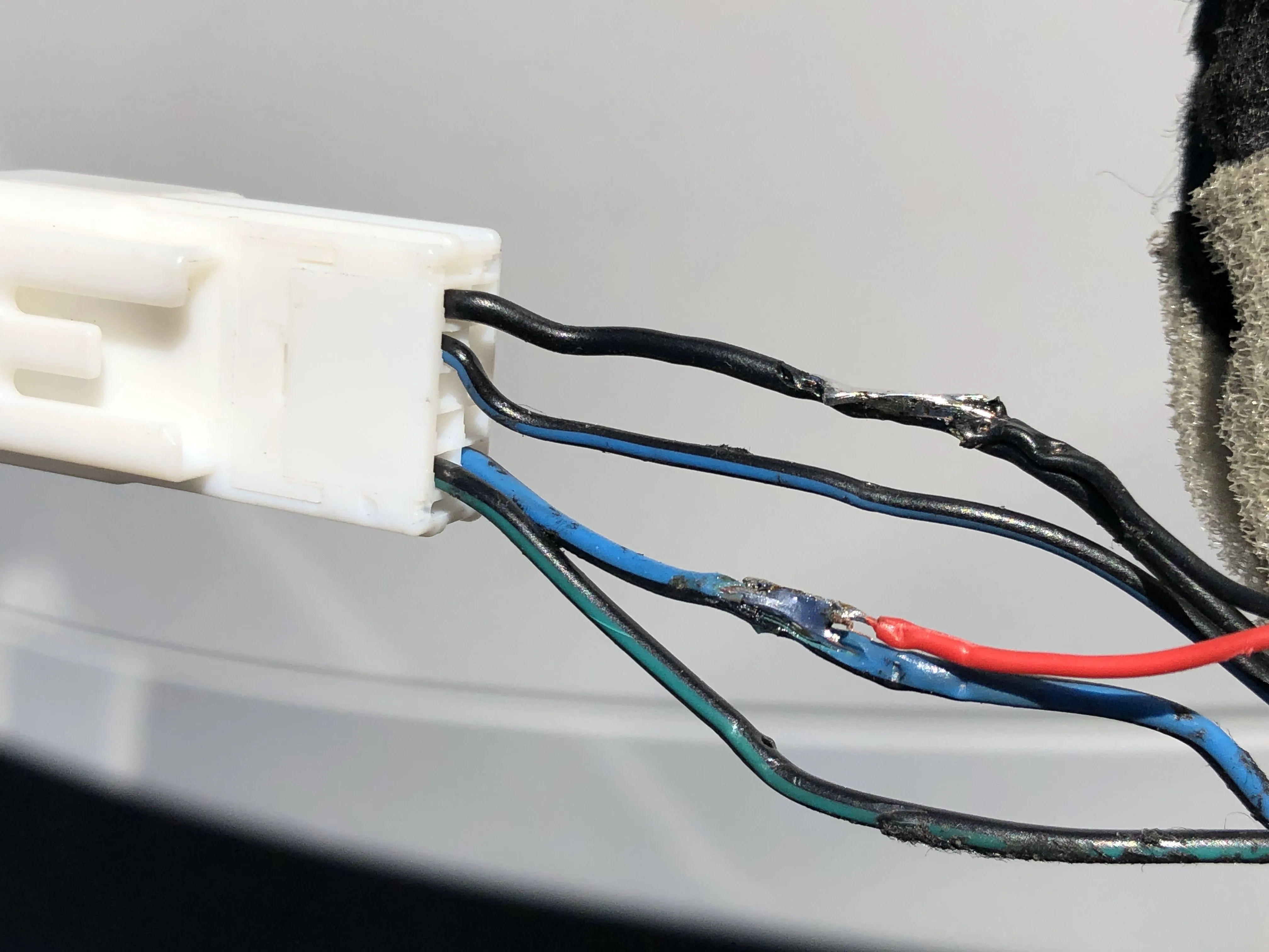

Hi,

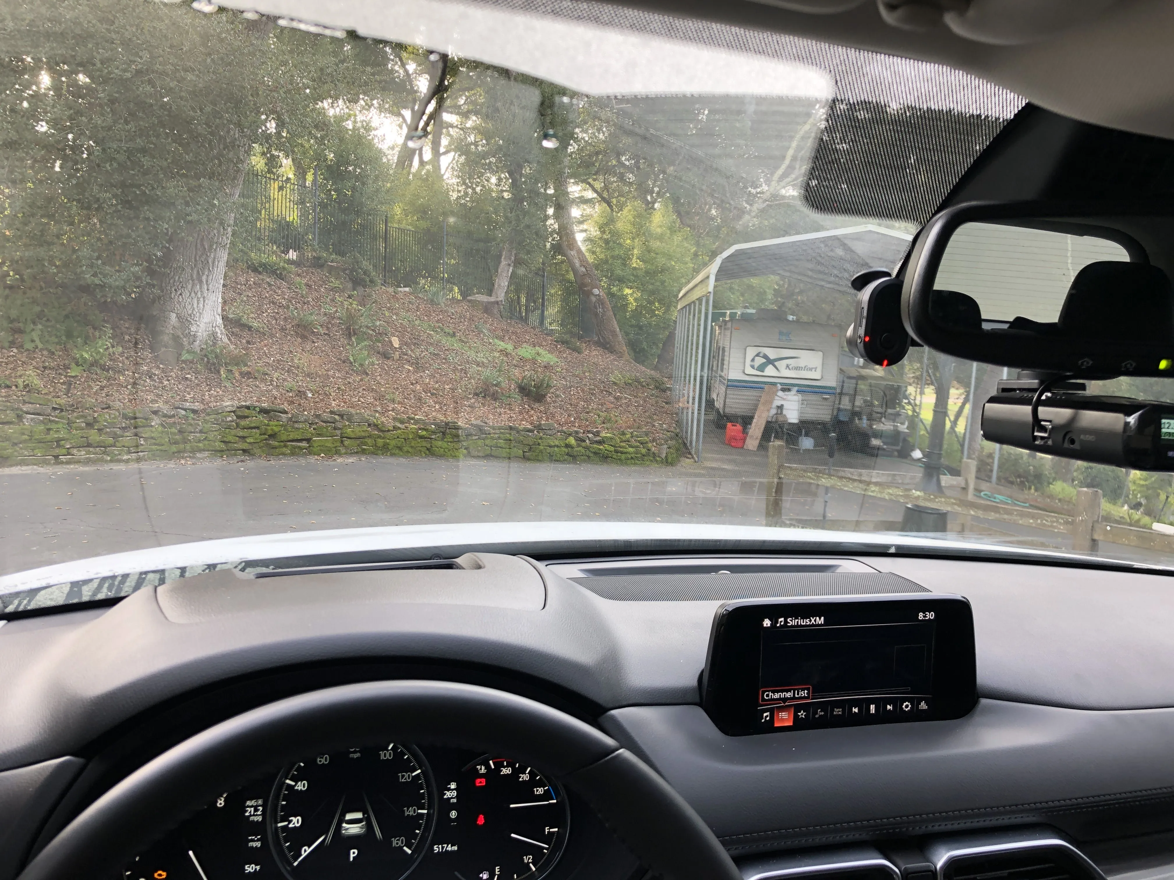

I just installed Garmin Dashcam Mini and a radar detector. I wired into the connector for the mirror. attached is picture showing the wiring. This is a 2019 CX-5 GT.

I just used an invisicord in my 2020 CX-9 that has the same homelink mirror as my 2014 CX-5. Was super easy to install with a Viofo A119.
Is the Viofo bulky? I was looking for something slim and its okay to put it on the black dotted area?I was going to put it towards the passenger side as opposed to the driver side.
The way I’ve installed it is pretty out of the way. I don’t really notice it while driving.
It was less in the way here than getting it inside the wiper area on the passenger side. Didn’t want my wife to have a camera in her face all the time.
As for mounting in the black dotted area, the lens is super wide so I ended up catching a bit of the dots in my view but othwerwise is fine. I could have fixed it by moving it an inch over.
