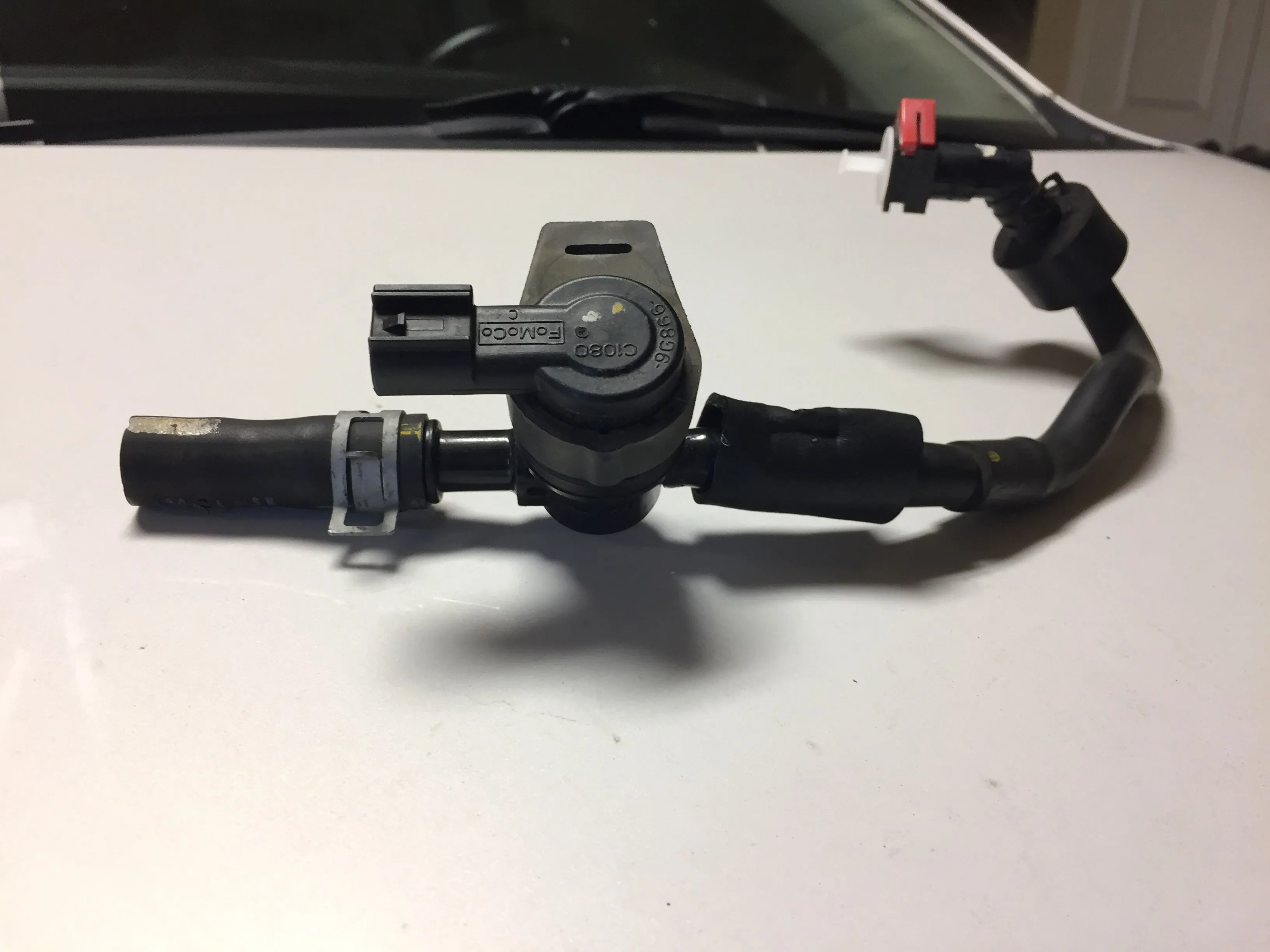

I replaced the purge valve. Mazda Purge Valve.webp This is what mine is like. On the firewall. It comes with the hoses attached.
Filled up the next morning and the car started right away. It runs smoother and the codes are clear. I still want to replace the charcoal canister.

I replaced the purge valve.View attachment 218483 This is what mine is like. On the firewall. It comes with the hoses attached.
