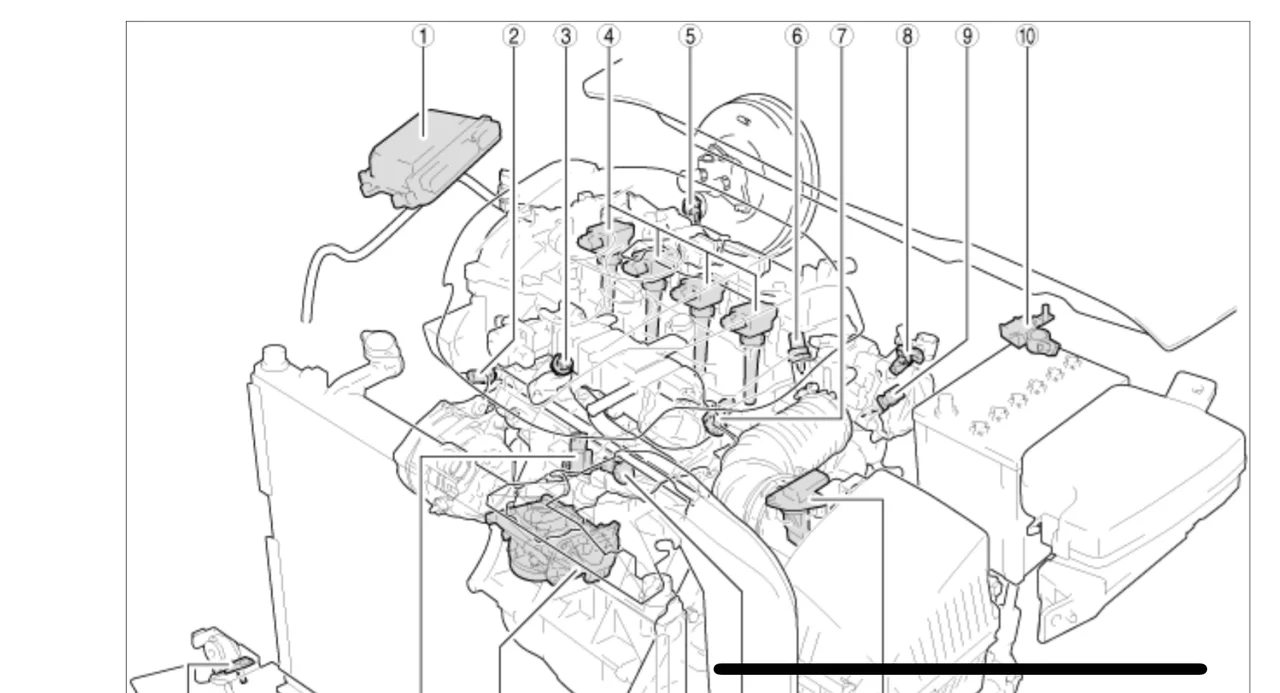

Oh my bad. I thought you meant the thermostat. I didn’t realise they were difdefent things. How about this one then ? The ECT sensor (engine coolant temperature sensor) is number 9. It is under engine/control system in the manual.
The manual says you only need to remove these items to remove it (in that order)
-drain the coolant
- plug hole plate ( the plastic engine cover)
- battery
-Air-inlet
So i think you should be able to see it without removing much, altough the inlet pipe may be in the way.
They also say you need a special socket to remove it though. (How special that socket is i am not really sure).
The manual also have a method to test the sensor (in heated water with a multimeter) to test the sensor and see if it works correctly.
Thanks, this is exactly what I was looking for. I had a feeling it might have been there - it was the only place I couldn't see that would still be near the thermostat. The special socket looks like its just a 12 point socket, but maybe the teeth are a bit different. I'll check later to see if I can just use one of my sockets. Most instructions for removing/installing ECT sensors mention using a basic 19mm socket.

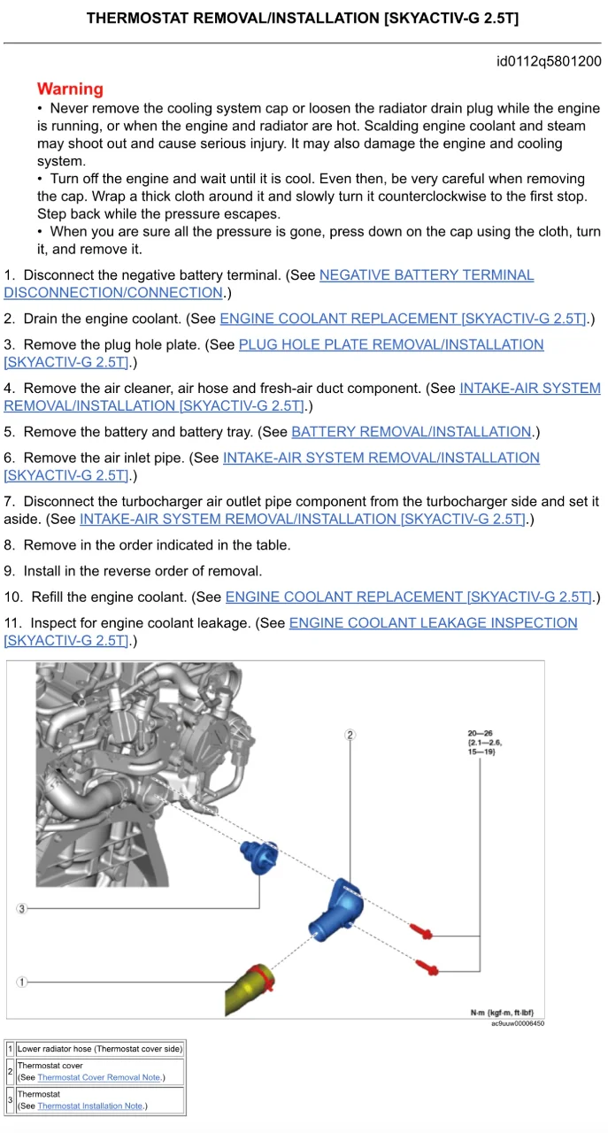

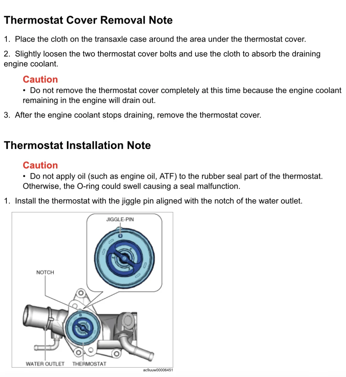

Hey @sm1ke, I’ve attached a photo of the step-by-step guide on how to remove and reinstall the thermostat. Hopefully, this is what you’re looking for!
- Shawnee
- Shawnee
Thanks Shawnee, this will definitely help! I'm hoping to tackle this tomorrrow/Thursday in my driveway lol.
