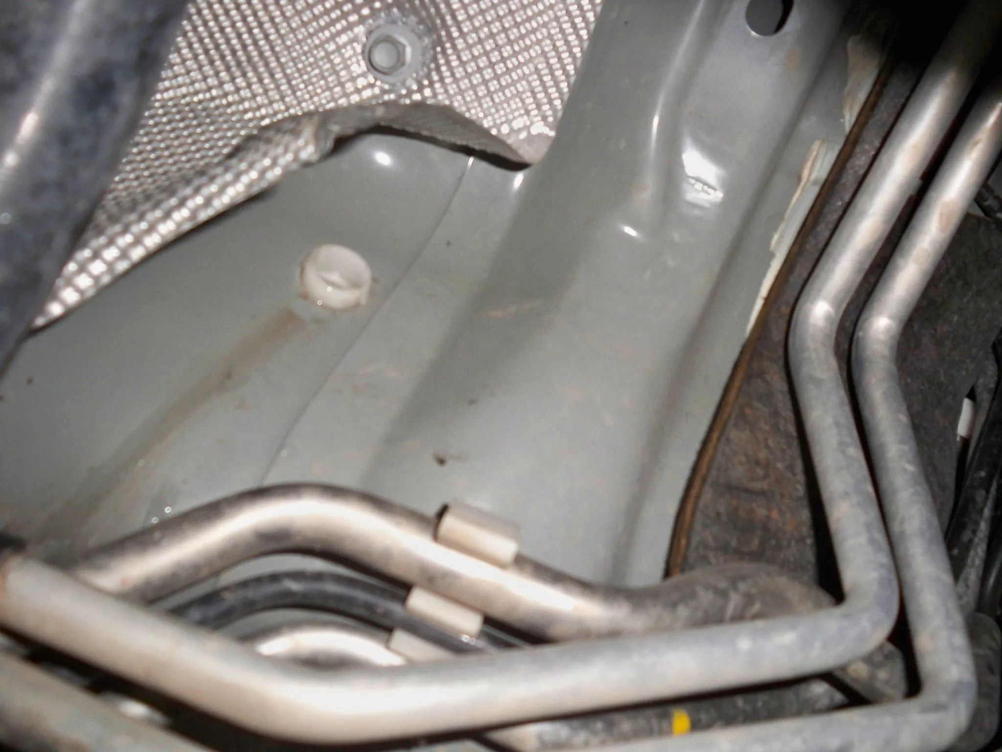

Late last year I had a sloshing sound in the dash of my 2008 CX-9. The sloshing sound continued to the point where, when I turned left (if I remember correctly), water would drip out of the evaporator case through the blower motor of the climate control system... and drip onto the passenger side floor. I eventually figured out where the evaporator drain is.
I've attached a photo. Take a look in the center "tunnel" underneath the truck. There is a silver heat shield in the tunnel, and the opening of the drain is behind it. The heat shield is bendable. My scientific solution was to bend the heat shield back, put a wet/dry vac on the drain, and bend the heat shield back into place. I'll bet almost a gallon of water came out.

Godd picture to let people know where it is. A few people on this forum have had this problem too.
Thanks for posting this picture and the solution. About a week ago I noticed water coming out of front footwells and heard a strange whistle while turning and found from searches that drian was most likely the cause. I crawled under and tried to work this spot with a coat hanger to no avaial but then grabbed a 12v air compressor for tires, balls ect... and plugged it in there for a sec then it drained real good. Well over a gallon in it.
First i would like to say thanks for the drain plug pic. Sadly i have had to do this 3 times in the last month twice in the last week. I am using a shop vac with a pvc elbow to make it easier to suck it out. My question is what else could be wrong that i have to do this every couple weeks? Any help would be great full

I've had most of my dash ripped out trying to get to the "tank" before I found the drain. It sounds like you have something more substantial in your tank than just some clogged up water. I used compressed air to blow mine in rather than vacuum it out. It's been fine for a few months now, but i have decided to hit it with the compressed air every time I put it up on the rack. I figure oil chnages, tire toations, etc, should end up clearing it 2-4 times a year hopefully. It sound like your drain hose is still mostly clogged. You might try to detach it and see if there is anything in there.

I just had to do mine for the first time today. After 8 years and 106,000 miles. Had the bubbling noise from water sloshing and in left hand turn you could hear the water hitting the fan spraying in the box making a hissing sound. Jacked the car up and put the shop vac on it. Sucked out some dirt and about two quarts of water. Fixed for now. BTW there are TWO drains! One for the front box is the one in the pictures above and the second one is farther to the back on top of the tunnel. Seems these cars have two separate evaporators, one for the front and one for the rear controls. There are also a/c lines going into the body near the back drain. So there must be a second evaporator.

so I followed your compressed air idea and literally a gallon of water came pouring out,

Once you have the car up, you have to bend back the heat shield to see the drain located on the vertical sidewall approximately under the driver's side
