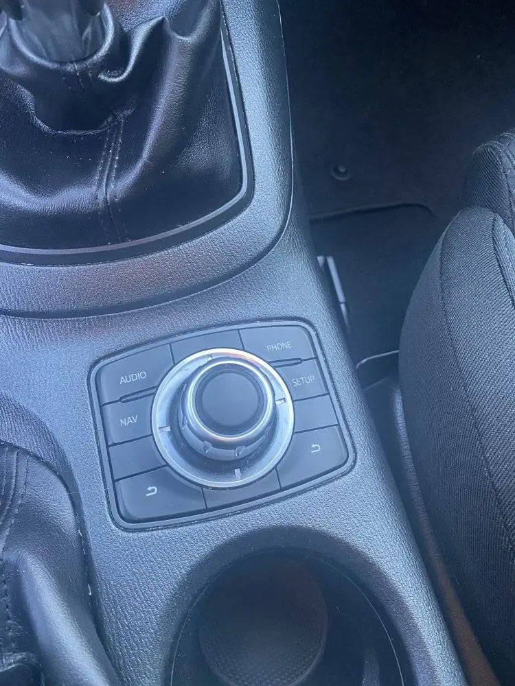

- does the control wheel next to the shift work (navigation, selection)
- do the buttons on that control wheel section work?

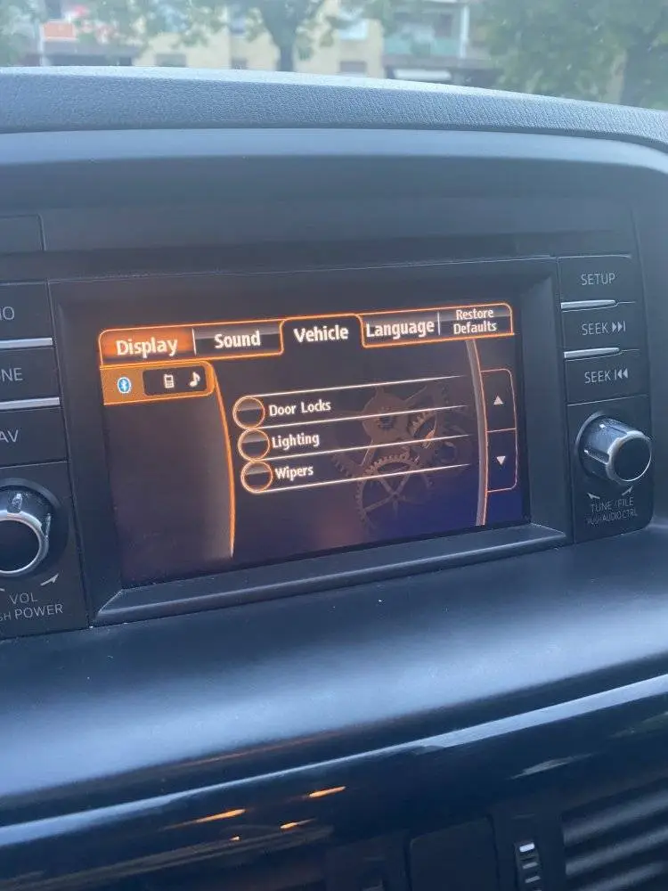

- can you access your door, lock, lights?

I’ve attached some images, so you know which wheel controller I’m referring to

Yep, Dasaita is OK, but no support for the wheel.

Already reached out to @theblooms, he doesn’t have the control wheel/joystick or any of those settings on his unit, so that’s a no go

I agree - just questioning my options about the lack of info on that joystick - I would either hide it and not use it, than to have it there and for it to be unusable.
I could be OK with not being able to adjust some door settings,which I never even edit, regardless 😃
