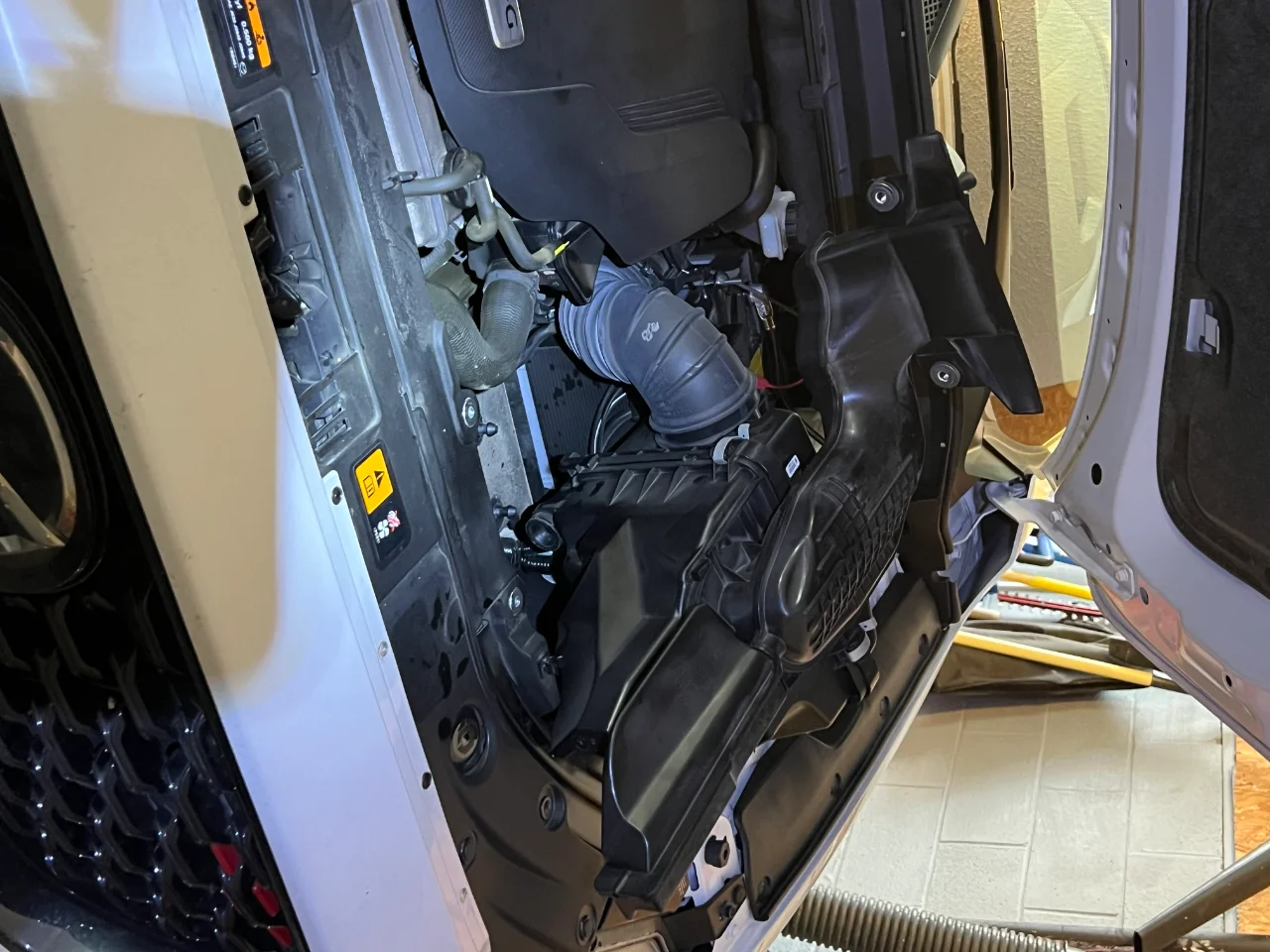

Woo! Got her refilled and no leaks. Another quart drained overnight as I left the drain plug out. About 5.3-5.4 quarts drained total. Needed 5.6 quarts to get to the block on the dipstick, temp was about 130F by the time I got the level right. Only 7 minutes or so at idle got the transmission temp to 110F before I started working on the final fill adjustment. Outside temp 65F
Funnel with a tube was perfect. Didn’t burn myself on anything. The air plumbing running in front of the transmission was bothersome but not too bad to work around. Moving the airbox was much easier on my ‘23 than it was on the ‘13 for some reason. And oh buddy the RTV was much easier to get off the pan and transmission on a newer car vs waiting 8-9 years! Came right off with a plastic scraper and some Motorcraft silicone remover.
Going to take her for a test drive. I’ll crack the old filter open and see what the media looks like under my kids microscope. Will post pics if they look cool in a new thread. Posted a pic of what the airbox looks like moved and connected to prevent codes. Website keeps posting it rotated too, sorry it’s not oriented right.
