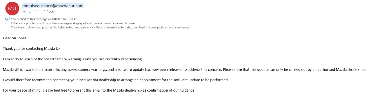

Update:
Mazda UK have confirmed software update is required for speed camera warnings to work.
