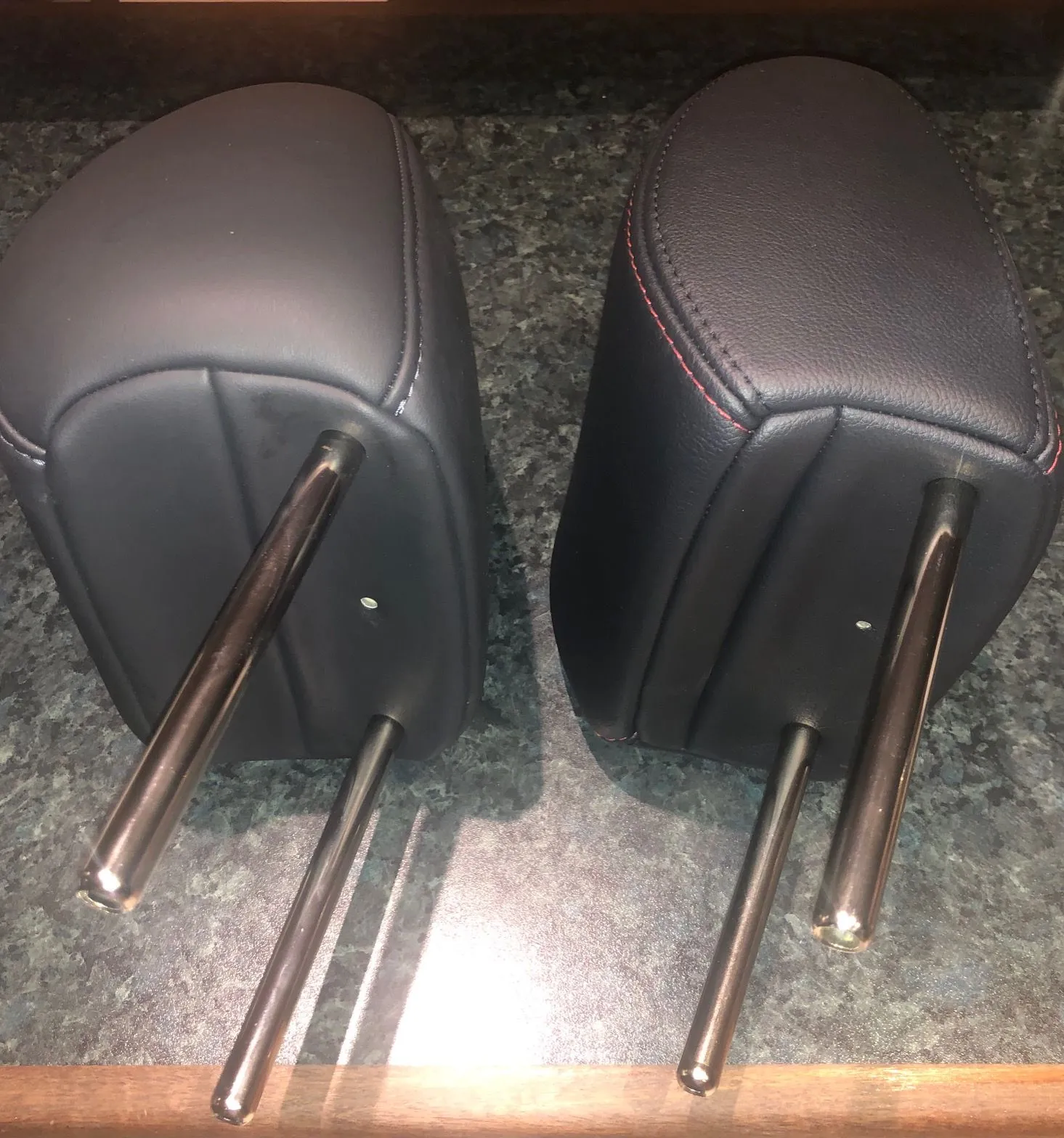

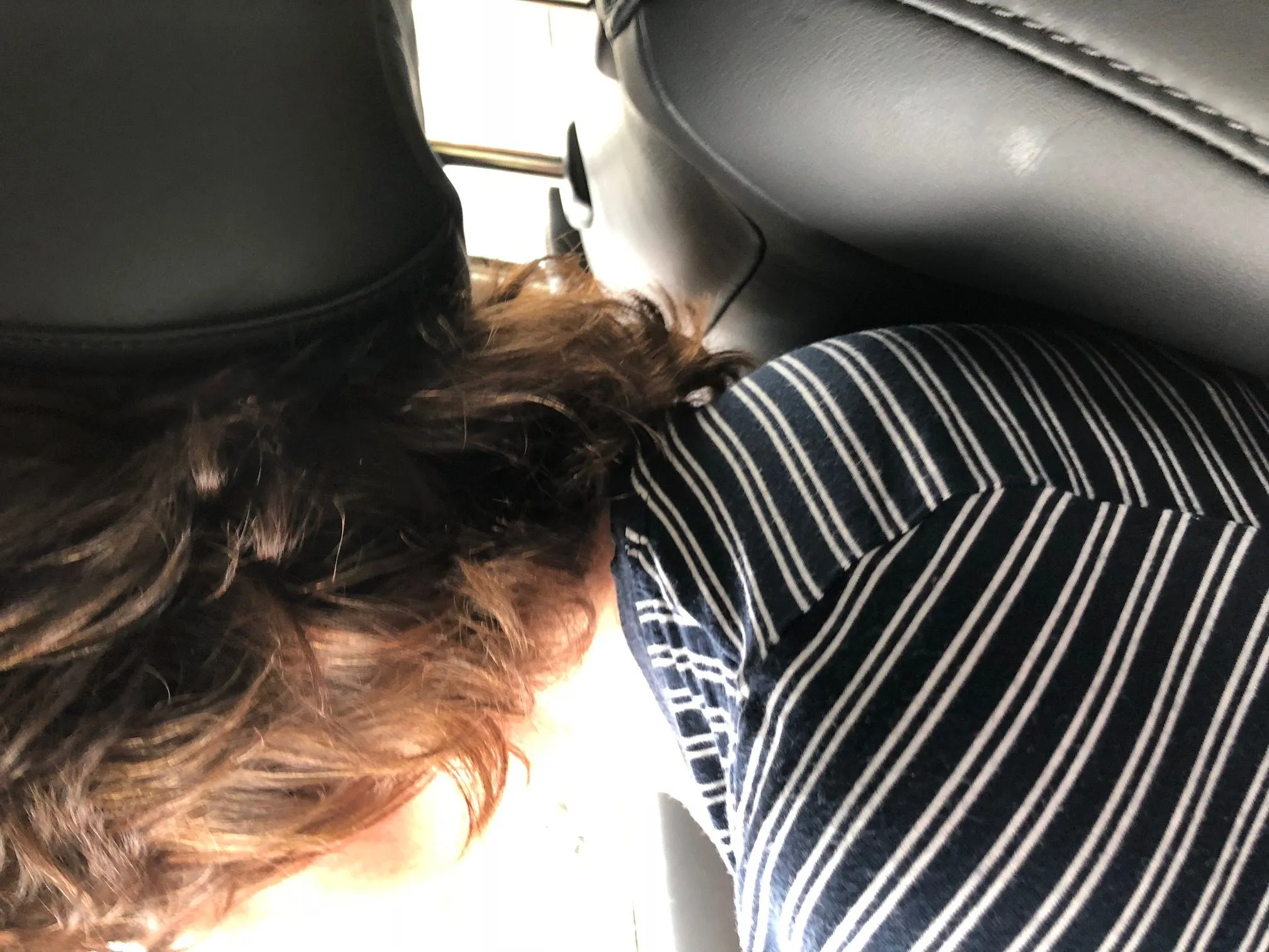

Update / solved
Brought another set of headrests with an aim of shaving the foam on the drivers face of headrests.
I asked for faux leather ones as per the wife*s gsx. But by mistake we got sent the leather wrapped ones from a Ltd model.
I*m looking closely at the leather ones and notice a slightly different profile and a much softer face.
The wife had now been able to move the seat to a more upright position and longer has her head tilted forward like the gsx set. She will run like this for a bit longer and then I get the leather ones reupholstered to match seats if no further issues.
Pic 1 Narrower headrest from ltd model on right
Pic 2 standard gsx headrest pushing wife head slightly forward
