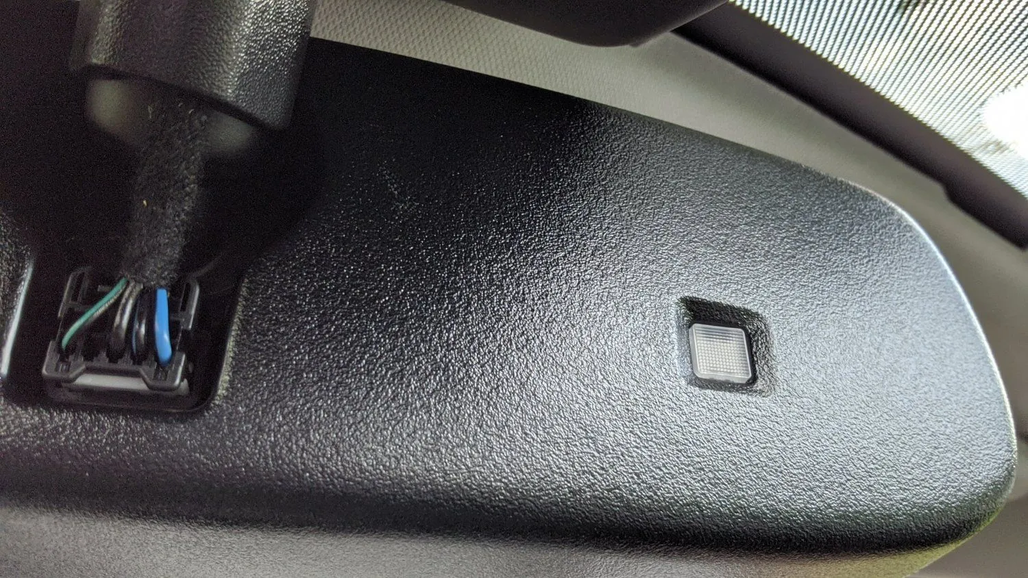

Right on. Any idea what this is for, on the back of the rearview mirror? For the auto headlights perhaps?
light sensor. for the auto dimming I think.
Correct. There's one on the front and one on the back (mirror side). If the light sensed by the back one is greater/brighter than the one on the front, the mirror 'dims' according to that ratio. If the other way around, or balanced, the mirror un-dims.
If you stick your finger over that front sensor in daylight, you'll see the mirror dim.
