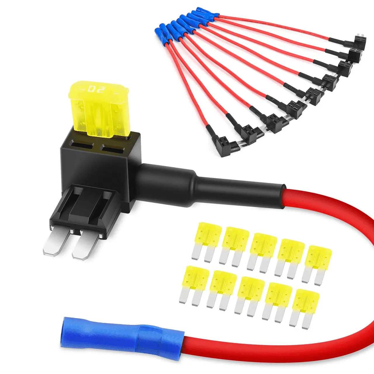

I put the Viofo A139 dual-cam in my CX-5 a couple weeks ago. Also put the HK4 hardwire kit in. I bought the
haisstronica Crimping Tool (crimper and stripper with butt splices)
along with
MuHize 140 PCS Low Profile Mini Car Blade Fuses
and
Nilight - 50038R 10 Pack 12V Car Add-a-circuit Fuse TAP Adapter.
I have parking recording on, and I monitor my battery voltage with a
CTEK (56-382) Comfort Connect Indicator Eyelet.
I have turned off wifi and GPS to keep the cams temp down, and reduce battery drain.
Routing the cables was easy, I just pried up the rubber molding, and tucked the wire underneath.
When you put the TAP adapter in, make sure to orient the wire 'tail' the correct way, so the current goes thru the fuses. Use a VOM to determine which leg of the female fuse slot is hot, and point the wire tail away from it, toward the unpowered leg. Pull the fuse and check that power doesn't flow.
