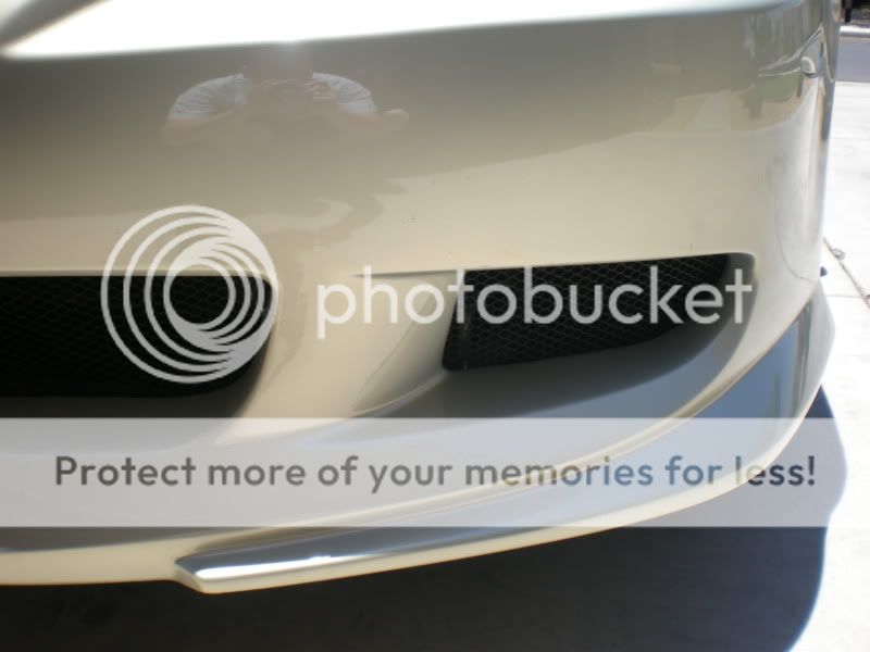

I own a 6 but I replaced my lower plastic grilles with black pc'd metal mesh from customcargrilles.com. You order a flat sheet of it (size is up to you), then trim it and attach it to your car. Pretty simple and the end result is awesome.
http://www.customcargrills.com/products.asp?id=1
Here's a pic of my 6.
That looks nice.
I've been thinking of that because I already have some like that in my upper grill.
Well, I'm not exactly how the grilles are attached to the Protege, but on the 6 there are little plastic tabs that the OEM grilles clip onto to keep them in place. I just put the OEM grille on top of my sheet and cut the mesh where the tabs are (it's okay if the mesh is bigger than the bumper cutout since it gets placed behind it anyway). Then after I slid it over the bumper tabs I drilled in screws thru the tabs (behind the mesh) so the grille won't accidentally come out. It's a little more difficult than it sounds (you need a nice set of tin snips to cut), but you guys shouldn't have too much trouble. Also, since my car is pebble ash in the grilles are black, you could see the tabs thru the mesh...it was not a good look, so i used a paint pen and painted the tabs black. Looks much cleaner.
I went with the black powder coated small diamond mesh in the 12x48 size.
Here's 1 more pic of the mesh:
My CAI drops the filter right behind the driver side mesh so I get a nice RAM-air effect (not reallllly but kinda). The car definitely feels peppier.
