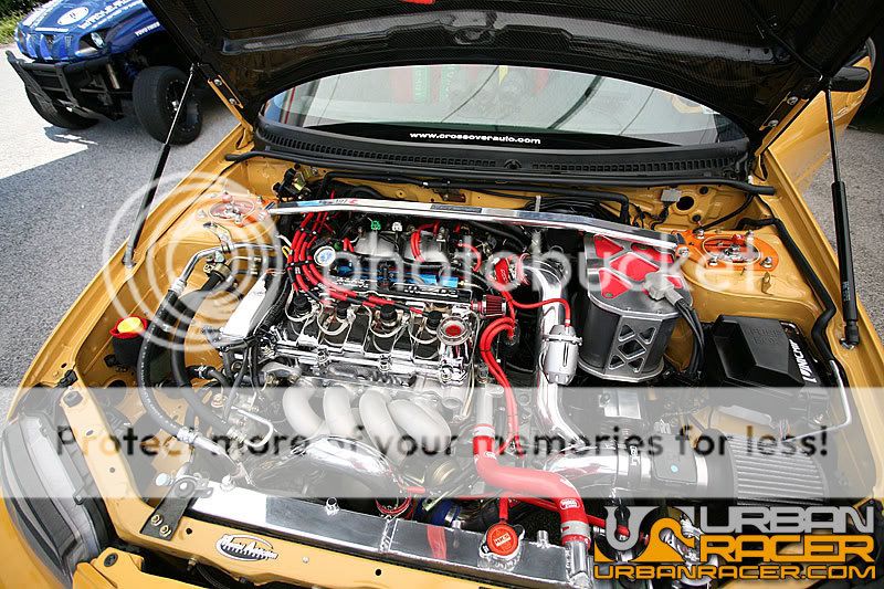

Current Engine bay pics everyone
i know its really dirty i havnt had a chance to clean yet

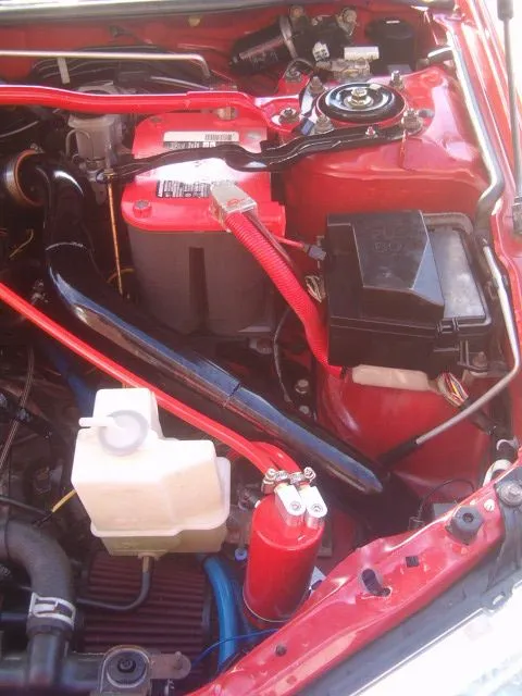

Ebay Optima battery tray :D

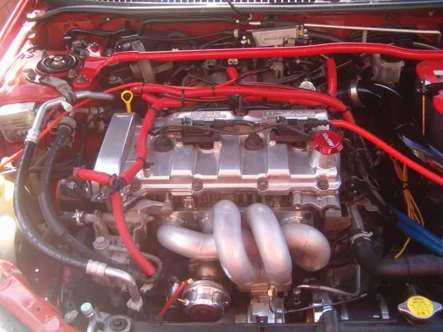

I love Vic's motor! I have to post my new intake :D
Really? Thats surprising. How's the quality? I've got a redtop and really want a better way to secure it than the little lifters it comes with.
That thing looks pretty sturdy. Personally, when I had my red top, I never had a tie down for it.. :P horrible, I know

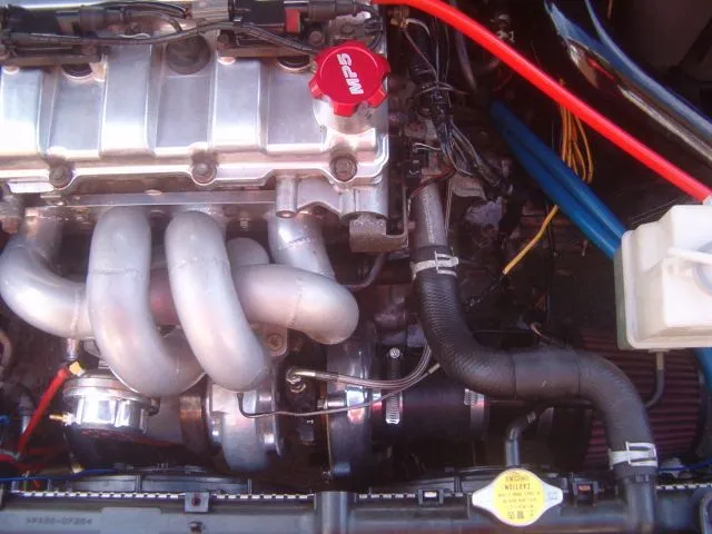

Ehm we have 4-lug disc-ed BJ 323/protegs here. Some 1.6 and most 1.8 engines have it. OEM EDM.

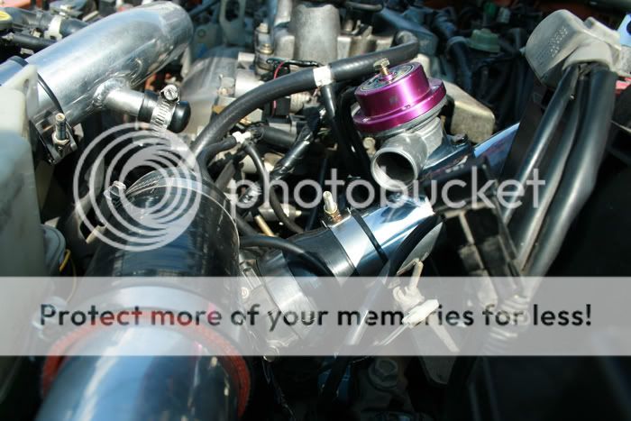

i'm having stalling issues and i just did my relocation kit... everything is installed, i don't know whats wrong.
also... if i place my hand over the bov while having the very rough idle, it idles fine. i let go and it stalls..
Are you running VTA? If so, the BOV should be before the MAF, not after. If what I think is happening, the MAF is reading a certain amount of air and adding the appropriate amount of fuel, but the BOV is letting some of the air out immediately afterwards so your car is running way too rich and is stalling out. That would explain way your idle is fine with your hand over the BOV - no air is escaping.
really...
well look the flange is welded on top where the elbow is and i don't think i can swap it to the bottom right?

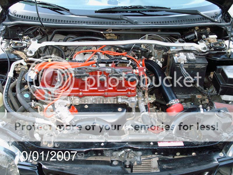

Here's some pics from a few weeks ago. I've since then moved a couple things around. Need to do something about the coolant overflow now.
Boricua: Your BOV is probably leaking somewhere. That doesn't look like the original adjustment screw on top of the BOV either. Might be the problem.
we replaced the screw on purpose, it was stripped.
also, i just fixed it. i just switched the bov to where the the maf was and now its perfect. runs great, no stalls and it sounds awesome! i adjusted it until i heard no turkey. i love it.
