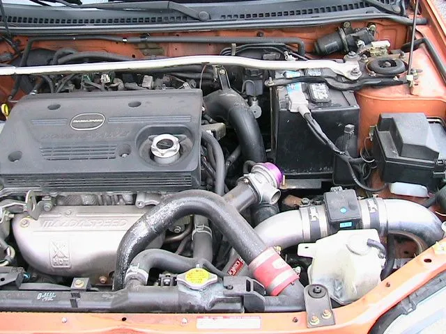

Jeezuz...do you drive your car? LOL..how do you keep it that clean?
altspace said:
No great mods, just clean.
he drives the car like 3 miles a day and only in good weather (actually i've been with him when it's rained once!!) the car is spot less..with about 30k miles or something...
no kidding, it looks like it's been sitting in some clean room in a wearhouse @ area-51 waiting to be discovered >_>

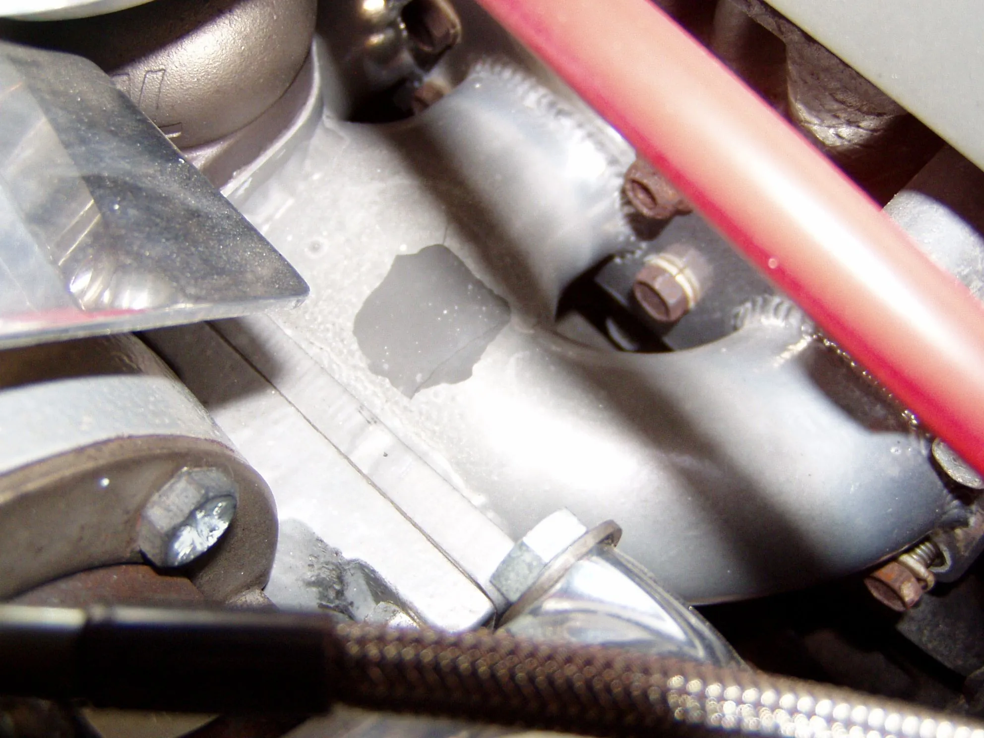

not current, but here's my first turbo install pic:
and find a way to brace the turbo so the mani isnt taking the brunt of the weight. u can do it with heim joints and rods. not too hard.
you guys are so helpful!! new gasket on order....fly cut? can you explain? ya, i think i should brace the turbo too....this guy i know who has several turbo'd cars, thinks some of the problem is the wastegate tube going into the downpipe (added back pressure?), he says cut it off and weld the down pipe closed??
Fly cut is machining the surface so that the surface is flat . I am not sure of the process . As for bracing the turbo by all means , there should be some bolt holes in the block to allow you to attach and bracket to and then to the turbo . I cant see why the wastegate tubes needs to be changed or removed ,if anything the spent gasses from the turbo would help the wastegate gasses move along
alot of times the wg tube will crack cause its under pressure (weight) (where the tube from the mani connects to the gate) thats prolly why he wants u to remove it. if u brace the mani/turbo, you shouldsnt have as much of a problem but it still exists when u have rigid tubing used as joints

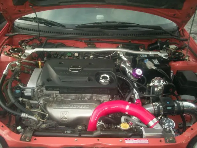

updated engine mods...before and after
thanks Alejo!
