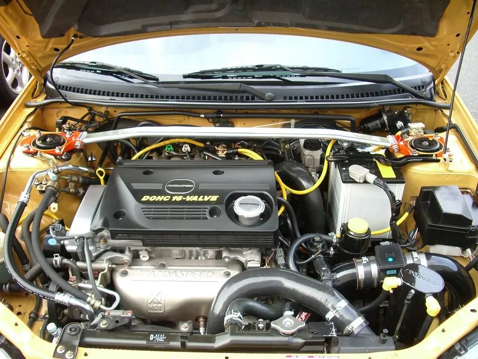

Whao, lol you have good observation! I just removed it (wipres) for the show, looks cleaner imo.
(peep)
Added black powder coated tower bar (thanks Jeff!) and new Forge blow off valve...

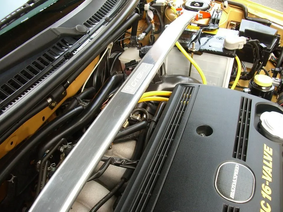

Where did you get that racing beat sticker for the strut bar? I was thinking a black one would look good on my silver bar.

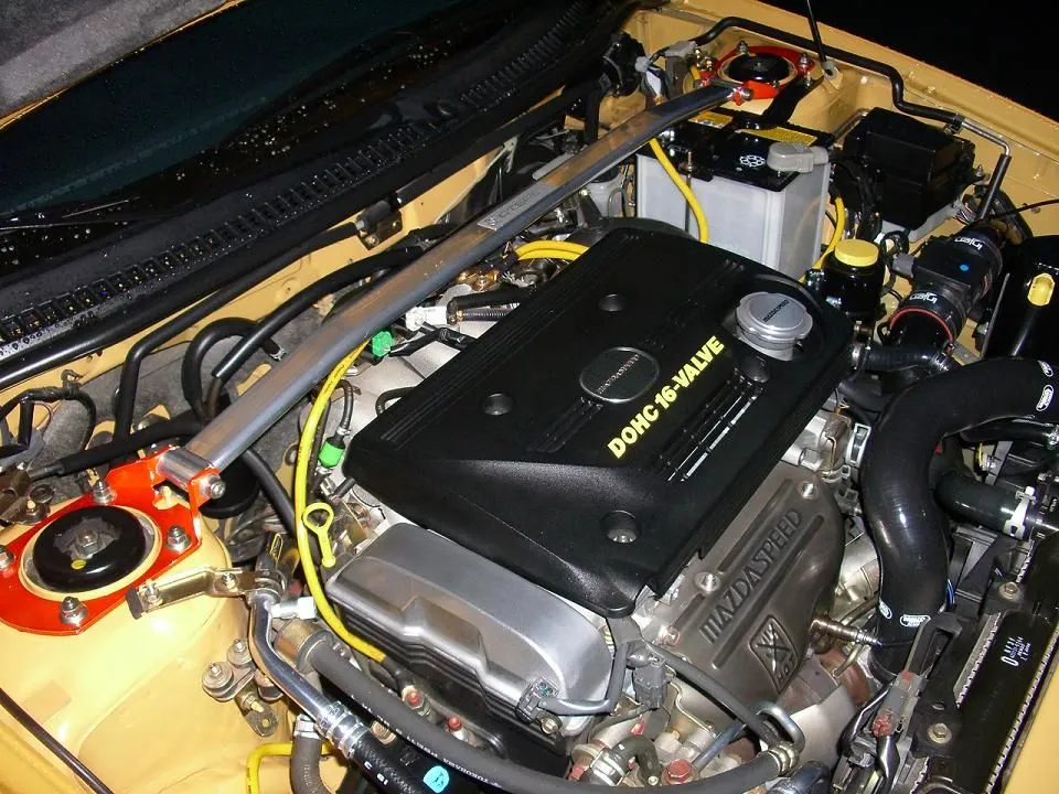

I can make it stall if I hit the gas a certain way but overall no. I changed all my turbo vac lines and made them as short as possible. I also called Forge and spoke to one of the techs there who used to fab custom turbos for multiple car makes. He is going to use me for sort of R&D for the MSP! He sent me 4 new springs (freee!) One of them is for the idle spring. He think the idle spring (lower piston spring) does not have enough tension to shut it completely so the car can recover back to idle like it supposed to quickly. They will be here Tuesday and I will take it apart and put them in. One of the other springs he wants me to try it a softer blow off spring, less tension than the green one everyone has used. He thinks this will help and if so others that have this BOV can use what I am using if they have stock pipes like me etc... more to come...

Strut bar looks nice by the way.
Talk to Jeff (MSP#735) I think I guy named Rickman can do them.

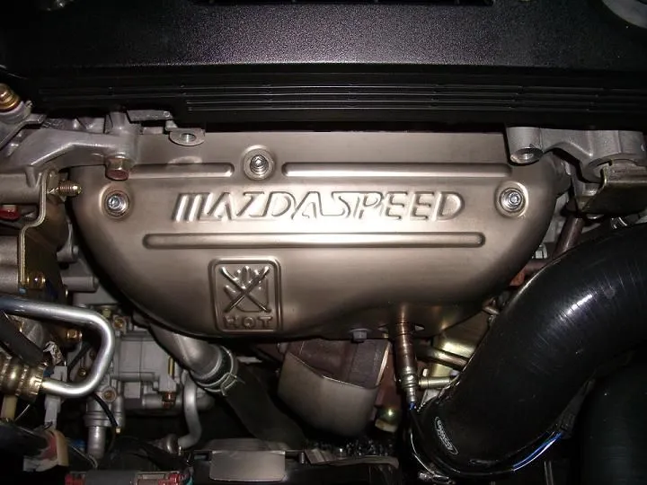

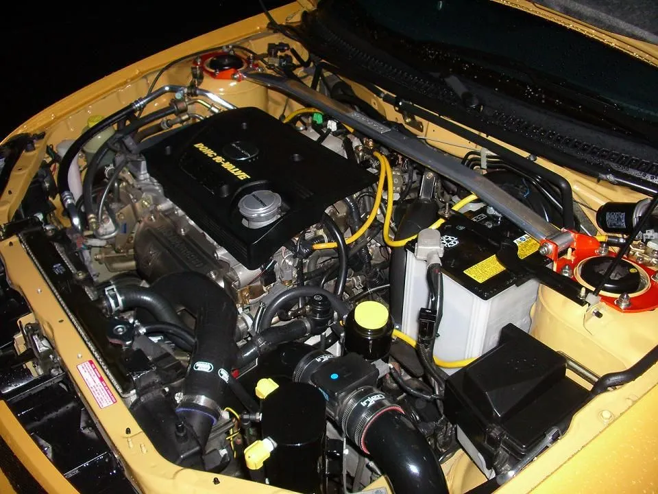

removed the strut tower brackets (left and right side), removed the old flat black heatshield bolts (only three of them, didnt have a tool short enough) and installed my new hex head bolts (thanks to Casper)..enjoy.
*fiber glass DG grill, greddy radiator cap and apex air diverter plate are next*
