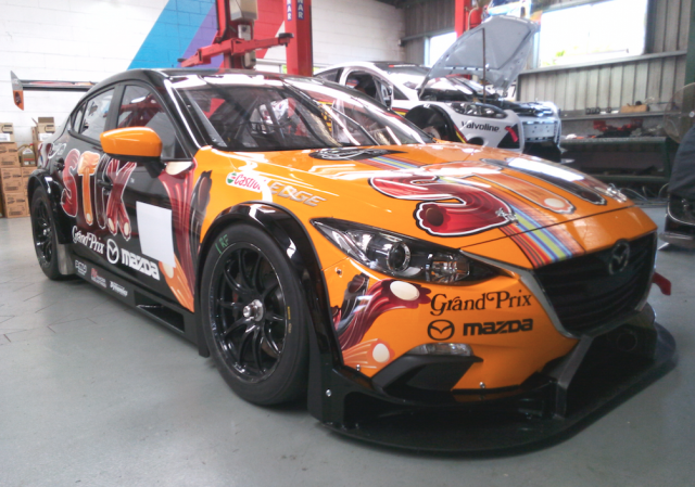

stick a v8 in it like this mz3?
http://www.speedcafe.com/2015/02/04/bathurst-bound-mazda-3-v8-breaks-cover/
