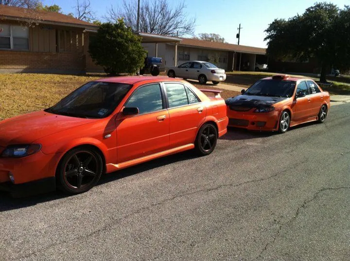

yeah, Ft. Hood is freaking huge and here is the kicker, HE LIVES IN MY NEIGHBORHOOD ON FT. HOOD!!! and has pics to prove it. He has pics of his car behind mine in front of my house. I was probably sleep or something.

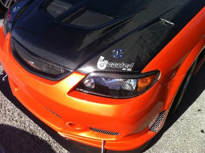

i dig most of it accept for the ebay cf grill and roof scoop. the spoiler to me is a bit much but to each his own. we should have a meet sometime between here and there. how far is fort hood from dfw? i would really like to meet some of yall face to face, i thought more woulda shown up at the big texas mazda meet but the turnout wasnt that huge for msp's and most the poeple there were locals. the group i came with were the furthest travelrs there.
