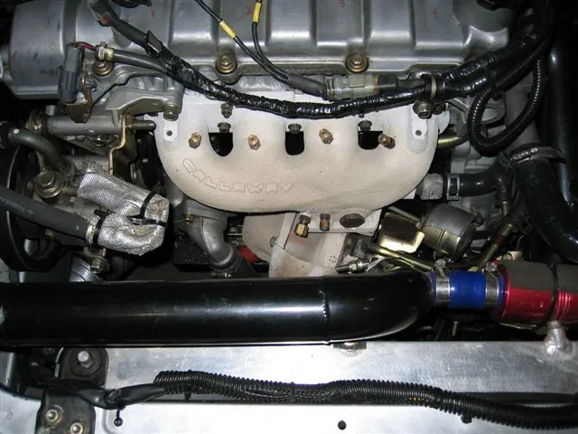

One thing I did find with the WRX.....many of them solved the cracking problem by coating their exhaust manifold. This is somehing we have used on the race car from day one and have never had (and hope not to have any cracks). The correct type of coating improves the performance of the exhaust and turbo system by keeping the exhaust gases flowing faster. It does this by preventing heat transfer to the manifold and keeping it in the gases themselves. (This is an oversimplification). In turn, this seems to also help prevent the cracking problem. Not 100% sure whether this is from evening out the heat or not allowing the manifold to get to the temps were cracks will form...I know for sure the manifold still gets hot as I have experienced in the race car!!!
Anyway, I am looking to get a cracked OE MSP manifold so that I can repair it and have it coated....will then test as this should be the ultimate in determining if this will work for the MSP.
If anyone is interested in the coating for their manifold PM or email me and I will give you the info.....Attached is a pic of the coated OE MSP exhaust manifold on the race car....

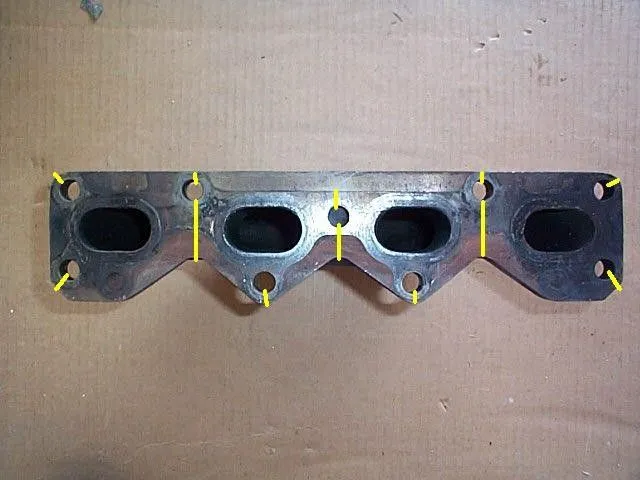

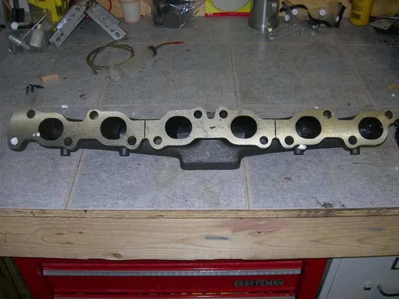

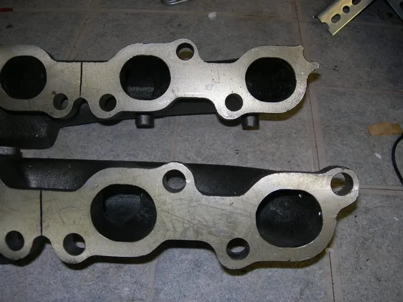

SOME MORE INFO REGARDING MANIFOLD RELIEF CUTS:
quoted from clusrsx.com
"they are slots we cut into the manifold for stress relief. It helps to ensure a perfect seal at the gasket, no exhuast leaks! an exhaust leak on a turbo car (whether from a leaky gasket or a cracked manifold) can make the turbo spool up ~2000 rpm later, and will drop power close to 150whp"
http://forums.clubrsx.com/showthread.php?t=417788&page=4
Page 4 of that thread regarding the stress cuts.
Some more info:
http://forum.ih8mud.com/showthread.php?t=114390&referrerid=15458
Here are some pictures also.
Side note:
I dont really see a need to boss the holes of the manifold. Does anyone find bossing (reinforceing) the holes necessary given the application. I think washer at the end of the bolt should suffice. Any comments or ideas on bossing the holes??
