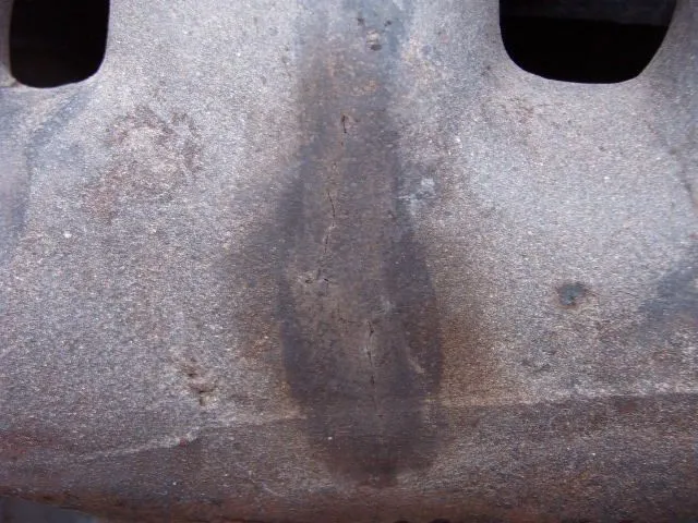

Crotch on runner 1

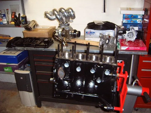

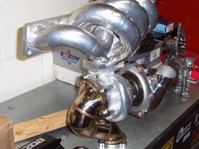

past my warranty, but I just welded it for temp. I have a replacement stocker I may slap on till spring when this "stuff" goes in:) :
