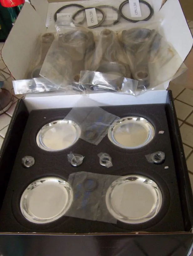

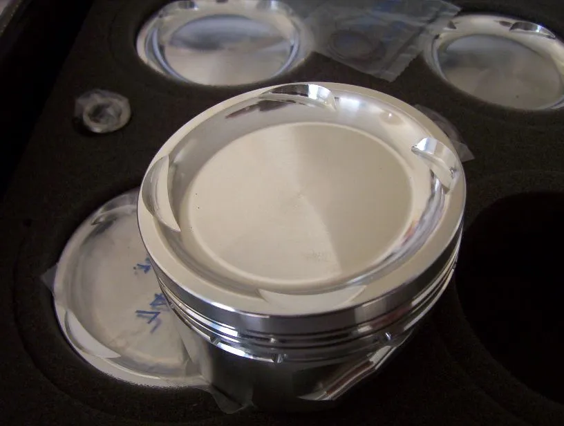

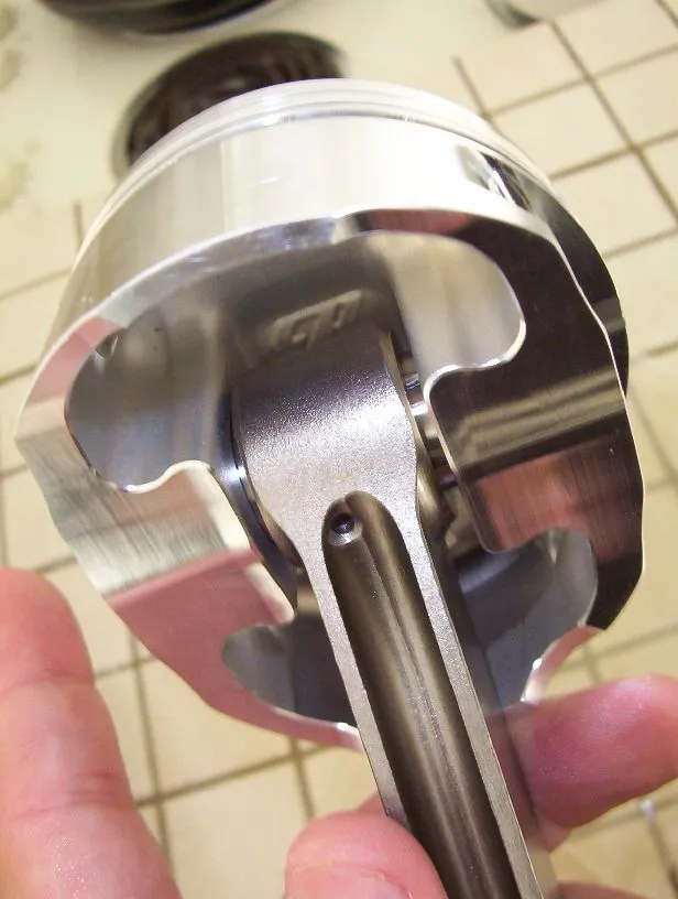

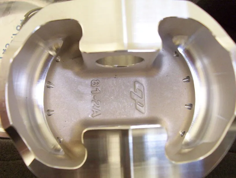

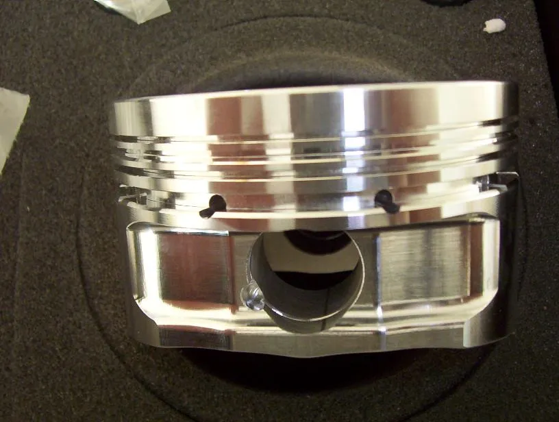

Mine are not stamped, and they are 8.5:1, at least thats what I ordered.
Check the pics.

thats ok i ordered stock bore and ended up getting over bore. good thing i measured them before dropping them in!

8 1-2A doesnt that mean 8 1/2? I am sure if you call CP they can tell you for sure. I know mine were supposed to be 8 1/2 and they had the same thing written on them.
Pistons generally come with a work order#. CP can pull that work order # to see what the specs are. Also, pistons generally come with a spec sheet.
If all else fails, simply measure the volume of the dish.
