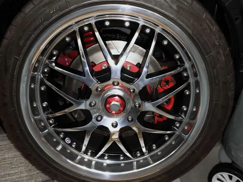

CENTRIC is a good brand. I have used it myself as well on numerous customer rides.
I am not sure what you gauge your assessment of the quality on? Price as I mentioned many times should not be item to consider a scale of quality.
IMHO you made good choice.
Another thing when using Rock Auto ... there pricing of goods is determined by the discount programs they get from the vendors, distributors or even the manufactures. Naturally a higher stocking level will be lower retail price points.
