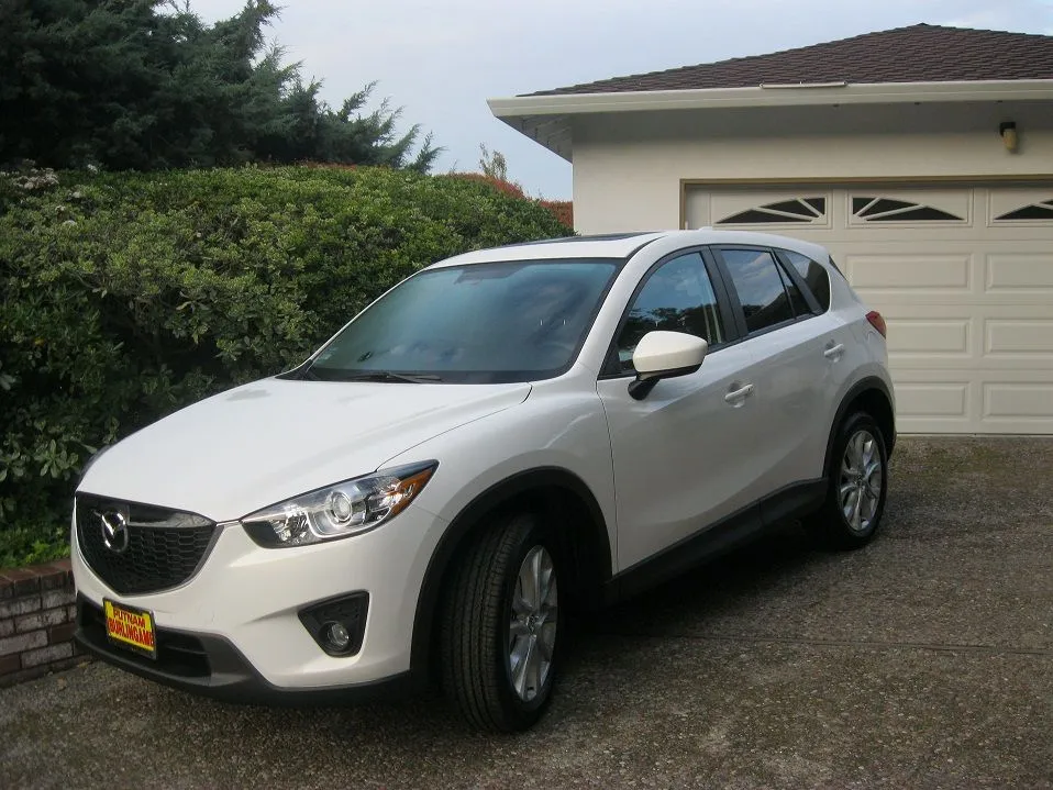

That's why I'm reconsidering the H&R option. It seems enough owners have used these springs with their 1.5"/1.75" drop and it doesn't seem to cause enough negative camber at either end to negatively impact tire wear. Otherwise, I suspect someone would have commented on it here or elsewhere. The one thing I really dislike about my CX-5, appearance-wise, is the overall height and the fender gaps. I even suspect that, with a moderate drop such as H&R offers, the stock 17" wheels on my touring model would look better proportioned. So I would really like to do this mod and this may be the year I jump in. PS: I make no claims to being an early adopter!
I would expect that drop to have minimal impact on tire wear too.
The CX-5 GT on 19's looks reasonably proportioned and looks reasonable sporty to my eye, kind of like a base current gen Cayenne.
