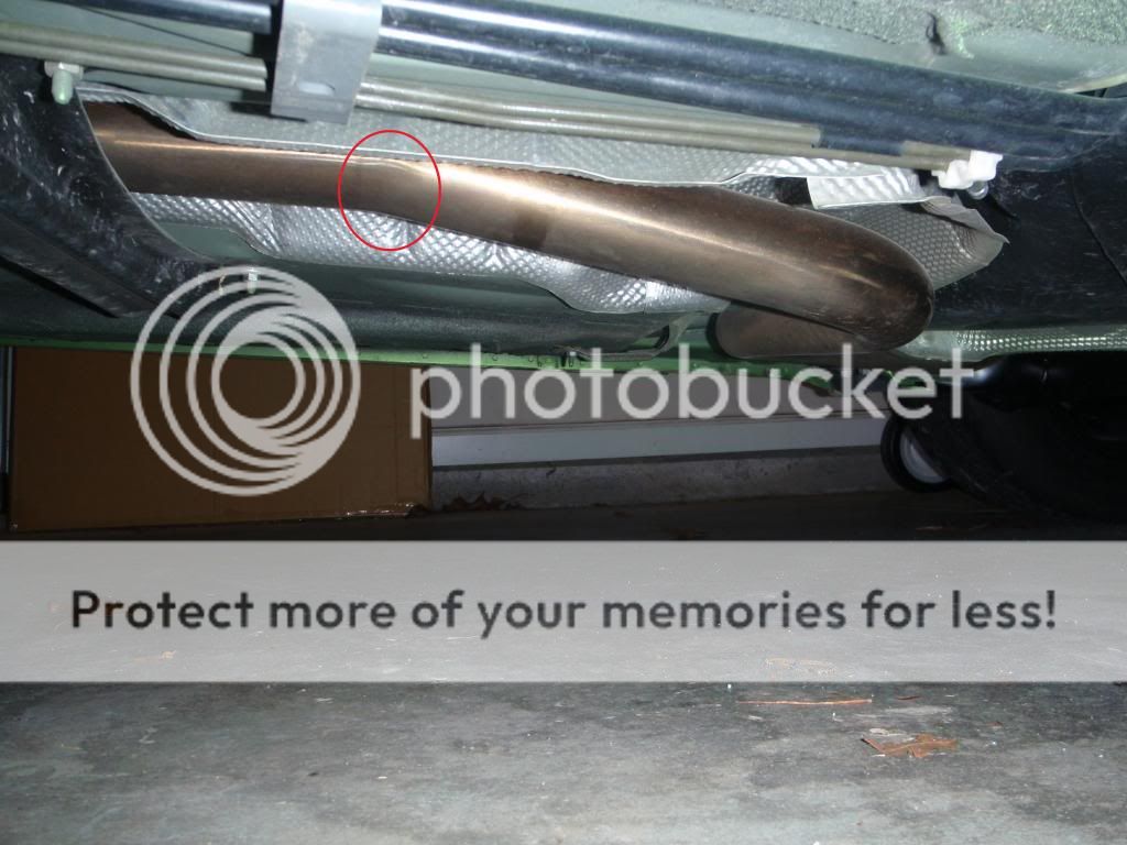

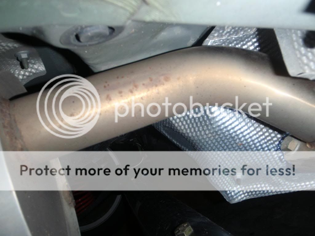

I'd like a show of hands if anyone else has the following fittment issue with the midpipe. Notice the bend after the cross-brace which causes the piping to drop down out of the tunnel.
Due to that bend, there are some fittment issues I've been sort of ignoring due to lack of time to deal with it. I wanted to make sure nobody else had a similar issue before spending more money on another midpipe from corksport (in hopes of proper fittment).

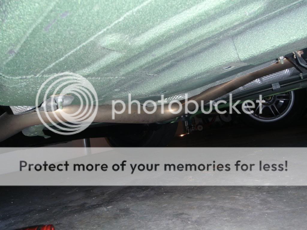

I run the whole racepipe system and do have a slight drop right there. Not as bad as yours but it droops just a bit. I haven never scraped it, too badly, on anything. My front end will scrape before I hit that. I've had it for over a year and just a week ago I checked everything put underneath the car and there is minimal scratching on it.

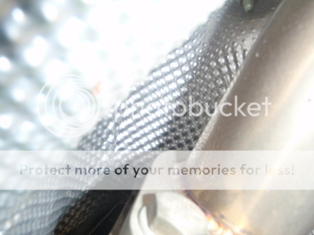

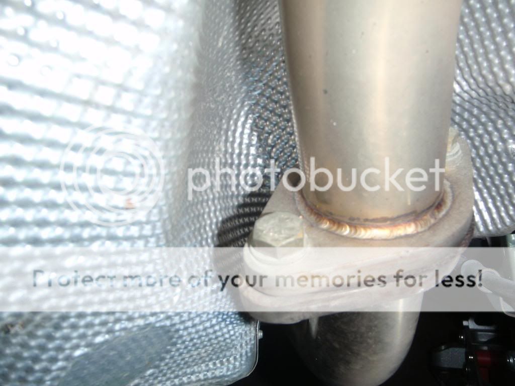

The fittment issue is that at the connection to the racepipe the piping sits to high, rendering the exhaust hangar useless (weight is supported by the racepipe), and at the back end the muffler section has to be shifted to line up the flanges and the piping (just before the muffler unit) comes in contact with the heat shielding and the rear tip is decentered as well. The owner at one of the muffler shops I went to swapped out one of the muffler hangars for a longer one, and that let the muffler drop down just enough not to constantly rattle.
I had been running it that way for awhile but recently it started irritating me again, since I noticed from standing outside the car a soft rattle can often be heard, that is solved by me moving the muffler a bit. I have mentioned it to derrick/corksport and they looked into it and couldn't tell what the problem was. We are still in communication though and trying to figure it out.

Swapped wheelsets and noticed a good spot to stick a camera to capture the problem area.
