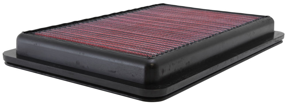

I have ordered a K&N filter K&N 33-2480 These filters are washable and reusable
I ran a K&N of the same design on my Ducat ST4s for about 8,000 miles. I switched back to the pleated paper media when I noticed a lot of very fine and abrasive road grit building up in the airbox (on the clean side!) Yee, it was well oiled because my Ducat didn't have a MAF sensor to worry about fouling. I cringe to think how much abrasive matter has been sucked right into the engine.
Since switching back to paper my airbox stays nice and clean and I have a little more power (yes, the cotton gauze is more restrictive because it has fewer pleats which translates to less surface area). I've also seen Dyno testing from experienced tuners who get slightly higher peak HP figures using paper vs. cotton gauze. It seems that the only people who get better flow are the makers of the cotton gauze filters.
The CX-5 paper filter lasts 30,000 miles. I would rather toss it and put a fresh new one in then mess with washing, drying and oiling an old used filter.
if you want to run a car 30kmi with the filter dirty that's up to you...i'll just replace mine when i see it's dirty
