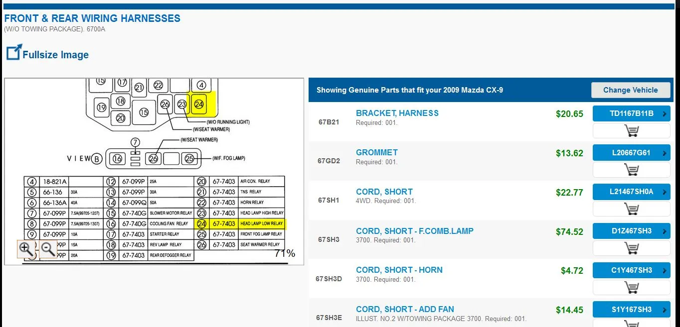

Second guess would be headlamp relay is not working, see diagram
