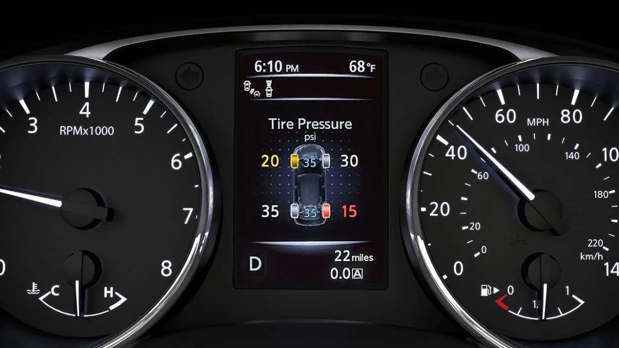

One thing I was disappointed about was the CX-5 not having a page on the instrument cluster showing individual tire pressures [each as a figure in psi]. Was useful when I had a slow flat on a rental car as could see the figure descending until it got to ~22/23 psi and then the warning coming on [showing the correct tire that was low]. May also be useful to easily see when a tire is down a few psi to prompt further investigation.
Though I don't think the rental showed the psi on the spare.
Yep, something like this found on Nissan Rogue would be nice!
Yea, that's nice especially as it shows the recommended numbers [if I'm correctly assuming that's what the blue 35 vals are] and also the units 'psi'. I believe the car system [TPMS] already knows the pressure in each tyre [inorder for it to know when to put the low pressure indicator light on] so it doesn't seem like a difficult/expensive feature to add in future years [more surprising it isn't there already considering I've had it in a few cheapish rentals - in my case I think it was a ford ecosport which was neither sporty nor economical!]
Anyway, what's with the pressures showing - 20 & 15?

⋯ Anyway, what's with the pressures showing - 20 & 15?
Yes, 35’s in blue are recommended tire pressure (front and rear, only for factory tires). 20 in amber, and 15 in red simply show this psi (or kPa in metric) tire pressure display has color warning capability (amber - warning、red - caution etc.) on purpose.
