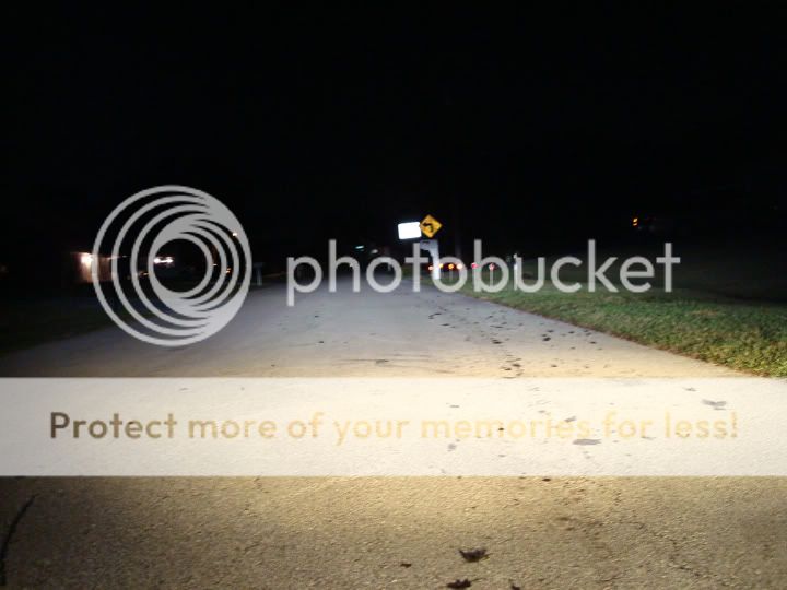

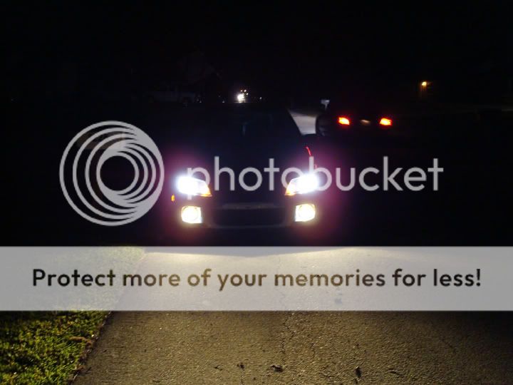

Just so everyone knows that Halogen's can do pretty good, here's my current setup. I'm running Silverstar Ultra's in my low's and stockers in the fogs with RockBlocker yellow on them
I'm running this till I save the $$$ for doing a projector retrofit.
Whatcha'll think?
Tylor
It's good. P5 lights are good halogen performers. Right in front of you i see two dark spots, on the left and the right. Is that supposed to be filled with the foglights?
on the shot with the car facing you? Yeah, I think that should be filled by fogs, but it's still the stock bulbs. I want to upgrade to the silverstars in there too. until I *Hopefully* get the 4000k HID kit for the fogs.
I have the headlights aimed a little high, but not bad enough to blind cars ahead of me. Does it look like the fogs are too far up or down? Any ideas?
