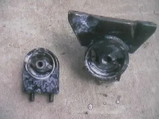

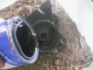

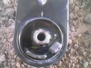

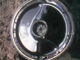

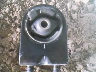

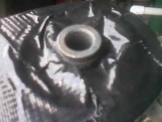

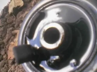

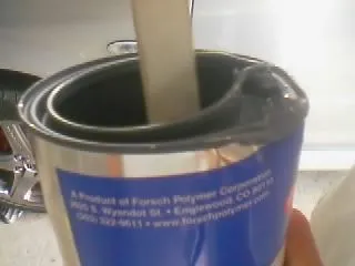

If you are in a buget like I am here is a cheap way to do it your self motor mounts. i bought a liquid on ebay for $37 shipped. here are a couple of steps if intrested. also pics took with camera phone not the best but they will do..
tell me what ya think...
Will be needed:::
DIY 80A Urethane Motor Mount Inserts Kit
1. Duct Tape - Seals one side of the mount
2. Contact Cement - Helps the duct tape seal against greasy surfaces
3. Degreaser - Cleans the mount of grease and oil to ensure an easy project
4. Sand - in a box - vital to the project - don't skip this one.
step 1. Take the mounts off the car..
step 2. clean the mounts with the degreaser.
step 3. tape one side of mount.
step 4. poor urethane in mounts.
step 5. wait 8 to 10 hours till dry.. make sure to wait!!!!
step 6. put back on.
they work great on my msp.. lil vibration but nothing to complain.. also i only did front motor mount and side passenger one... NOw I feel the speed...

There is another type that dosen't get as hard as the window weld which takes away some of the vibration....

Hmmm... I couldn't find any brand names but it seems that Liquid Urethan can be purchased in different hardnesses
