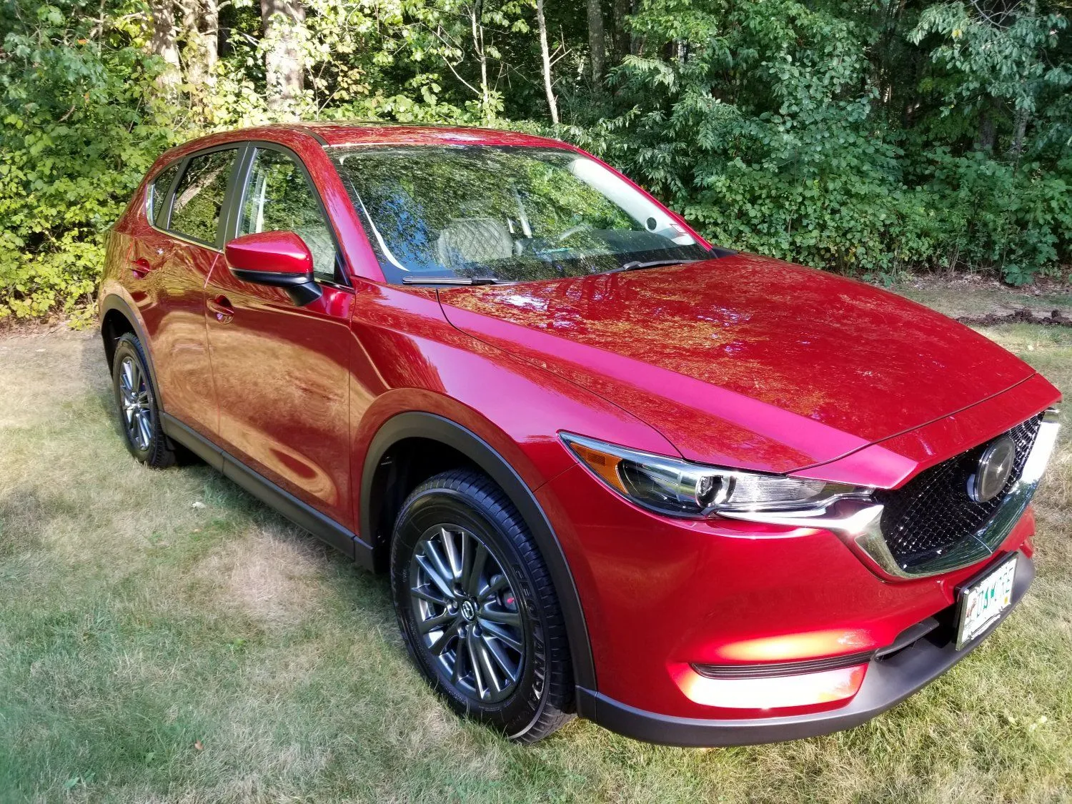

Don’t forget the interior as well. In my CX5 I used Gyeon Leather Coat on the seats and in the soft panels of the doors. Rain just beads and falls off. The surface remains smooth. The finish is a low satin which is ideal for interiors.
