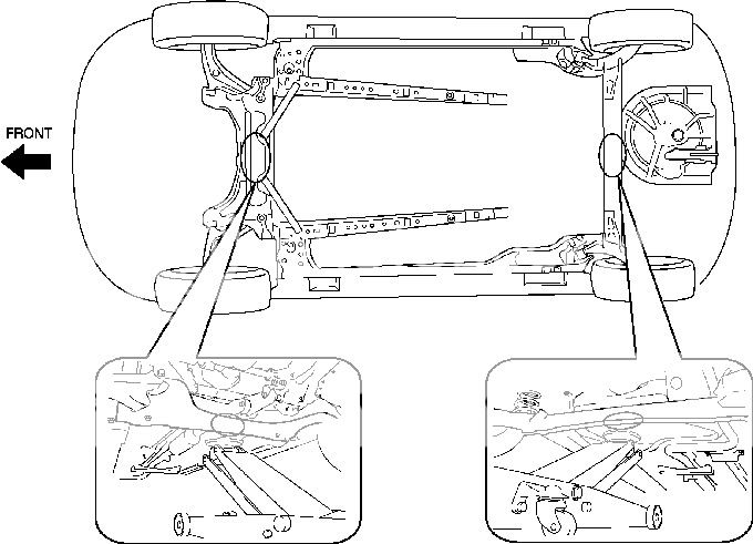

factory service manual isn't out for this thing yet, huh?
I have manual at work and will look this up in a bit. Gotta do some work first.
Here you go:
Yeah, surprised me too. I found this pic and saved it from a different thread on here. I've jacked the car up at least 5x using both these jacking points and had no issues. It's actually easier for me because whenever I tried to jack one side the whole car would scoot over as I jacked it higher and higher... So weird, never had that problem with any other car! I attributed it to the torsion beam setup but I'm not really sure if that's the cause.
