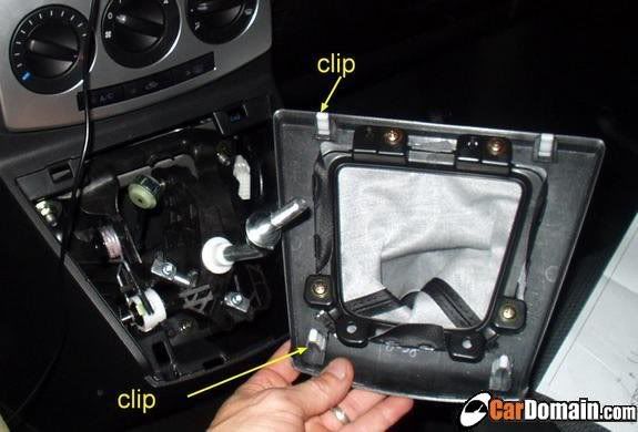

1st Unscrew shift knob.
2nd Pull off silver plate under shift knob. Clips hold it on. I was able to use my fingers to just pry it up.
3rd Unscrew 2 screws exposed under shift knob plate.

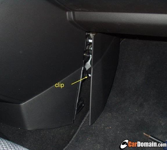

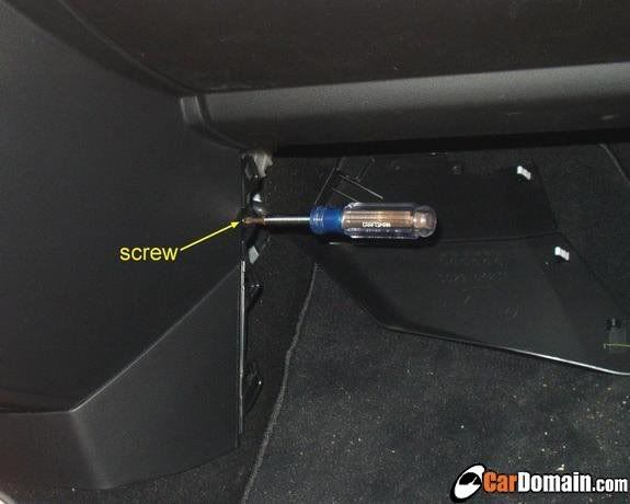

4th Pry off black plastic panel by gas pedal and similar panel on passenger side. Both are held in by clips and were easy to remove.

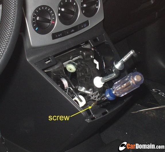

5th Unscrew the shift console screws exposed under these panels.

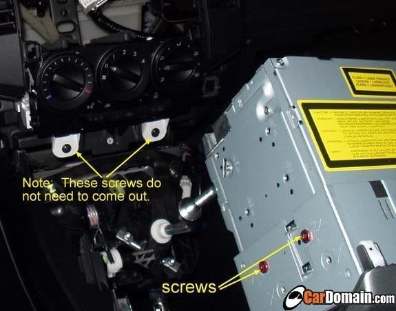

6th Pry off silver panel around radio. I thought it would come off after the big black plastic piece that surrounds the shifter (shift console?), but I could only get the silver panel around the radio to come off with the console. I never did separate the 2, didnt need to. Note that the radio and all dash knobs come out with the silver panel. They do not need to be removed first
7th Unplug the radio, unscrew the radio from the backside of the silver panel and slide it out.
