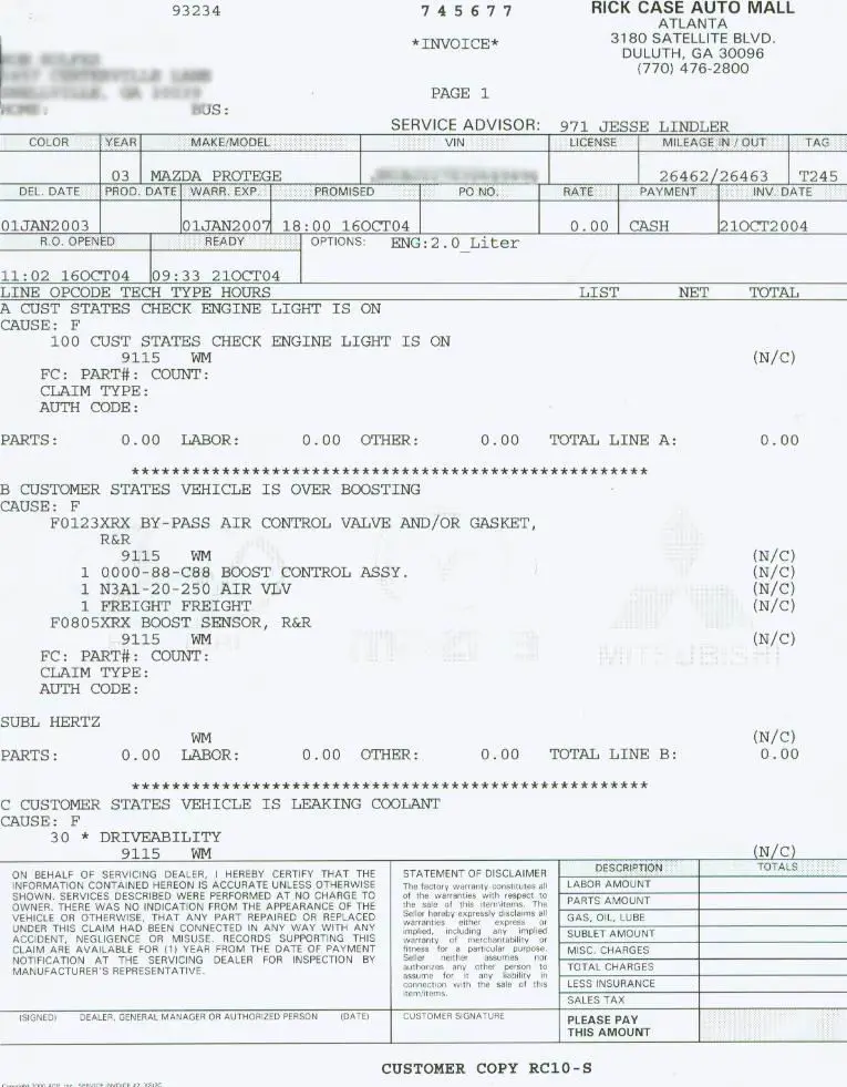

i have gotten this code many times now, and i have yet to figure out why. i took it to mazda they claim its a bad O2 BUT they didnt replace it. that was the first time mazda looked at it.. I just got my cat back today from mazda agian but this time i had many other problems for them to look at like overboosting to 15 psi, coolant leak etc. ... well the car is still over boosting go figure. well anyway back to the topic they are telling me now that the CEL is from the muffler that i got put on the car, that its leaking. i told them bulls*** i brought the car in once before, when i didnt have the muffler and you told me it was a bad O2 but didnt replace it. so im kinda stuck right now with that, im getting a full catback put on then im taking it back and saying the exhaust leak is fixed, not fix the car right this time.
they did replace some parts
By-pass air control valve and/or gasket
boost control assy
air vlv
boost sensor, R&R
and now my idle is better and stable and im not stalling at redlights
What the hell is a boost control ass.?

hell if i know, all i know is that didnt fix s*** that was wrong, and i forgot to mention that my belt is coming off the pully and they didnt fix that!@!
and my turbo sounds like ass when its spooling so there is something wrong there but they wont replace it, the gasket on the turbo mani is shot and leaking but they say its not! im just going to keep taking it back to them until they fix it correctly
