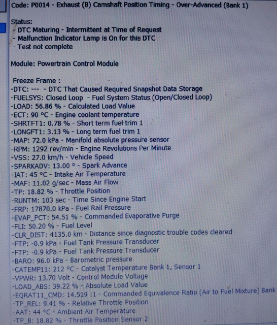

make sure to scan it with a good tool and you get some extra info like this below. once the code and data is known we can try figure it out.
All you need is a $5 obd2 (tbh surprised you don't have it) and reference the code in the manual. P0014 is the money in that screen. Most of that other info is very extraneous as presented.

I thought so, but bad fuel should cause a bad idle. It cranked "poorly": and shuddered to death before I left work. I cranked it again and drove to the dealer. They pulled codes and knew everything about t he vehicle when the CEL was set, right down to my mph speed.
They also said the engine coolant was 50*F (they may have misread and it was 50*C, but that's only 122*F, and that's still absurd).

ShopkeyPro gives different code definition, Hydraulic variable valve timing control system: over-advanced. Too bad they did not read pending codes, this would help a lot.
I'd pull the engine cover and check oil control valve at the back, passenger side, on top of engine. If it is leaking or the connector is loose, I'd start from there. It could have been knocked off while replacing plugs.
