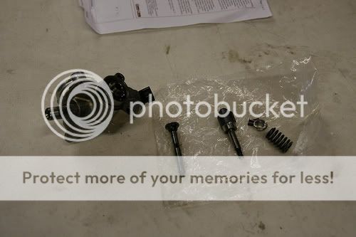

I will say that all that was the hard part and things will be easier from here on out.We are starting with this.
First pull the spring and stock plunger straight out of the pump. This is the stock plunger (left) and upgrade internals and stock spring(right).

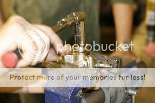

Now support the pump in the bench vice a grab a buddy to steady this thing. Be careful of your lines and sealing surfaces against the vice. Remove the 18mm nut that is now exposed where the spring came off. Righty tighty and lefty loosey.

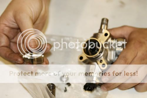

Here you see the 18mm nut assembly removed.

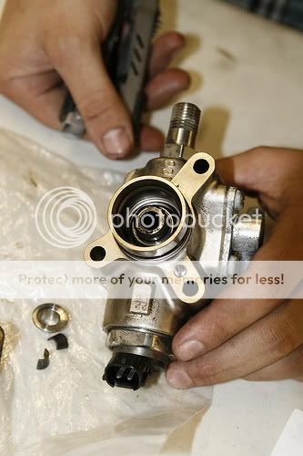

Now gently use needle nose pliers to lift the stock piston out. Notice the small shoulder and large shoulder on the piston. The large side points out towards you.
Now dip all the reused and new parts in gasoline and then slide the upgrade piston and shaft into the 18mm cap. The small end with the retainer groove will be outside the pump. It is unclear if the internals come with the pistons on the shafts already but make sure yours looks like pictured in the first steps above before forcing anything together.

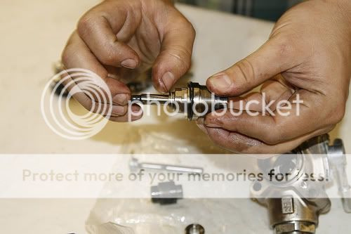

Now slide the spring over the external side of the shaft and seat it on the grove it originally came off of. The spring retainer goes on next with the centering dish going into the spring. Put on the 2 retainer halves and balance everything. Push the retiner end into the assembly jamming the retainer into the spring retainer. The spring is now centered and assembled like pictured below.
Let this assembly sit in gasoline for a few minutes and take a breather if you want. This pic is out of order in the build sequence you should have the spring installed at this point before reassambly.

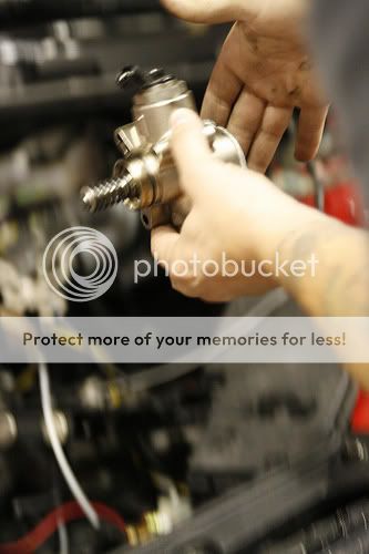

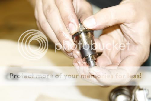

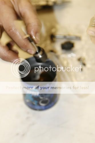

Make sure no foreign objects fell into your pump and begin to screw the assembled spring and piston assembly into the pump housing by hand.
Once your confident the threads are engaged properly put that deep 18mm over the whole spring and tighten her down. I was not given a spec for this but it is very tight to remove so make it very tight. Again beware of the o-ring, fuel lines and now spring sticking up into the socket. I would say the pump is ready for reinstallation now. Put some fresh oil on the tip of the spring side that rides the camshaft and the o-ring. Use the 3 E-8’s to evenly and slowly draw the pump onto the head. Also be careful to not bend or mutilate the threads on the 17/19 mm stuff underneath by slightly wiggling the steel line downward to allow an even seating as the pump nears its final installed position. Make sure to hold the 17 and do not allow it to spin at all while putting the 19mm nut on. Do not cross thread the 19mm it will spin on freely by hand until the very last turn.
