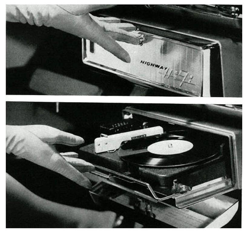

It was the same way in the 80s trying to get a cd player into your car. LOL

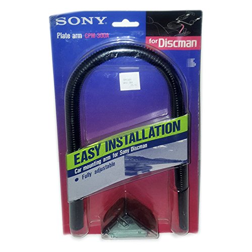

Yes, but even before they were able to make CD players that would fit into cars, we had to find ways to rig up the PORTABLE CD player to play in a car.
Typically mounting one end of a flexible arm like this one to a piece of the dash or center console so you could mount your CD player on the other end of the flexible arm, and play CD's thru your CASSETTE Tape slot. Of course all of this would only work on smooth roads without any bumps. (nana)
A true audiophile will always find a way...
