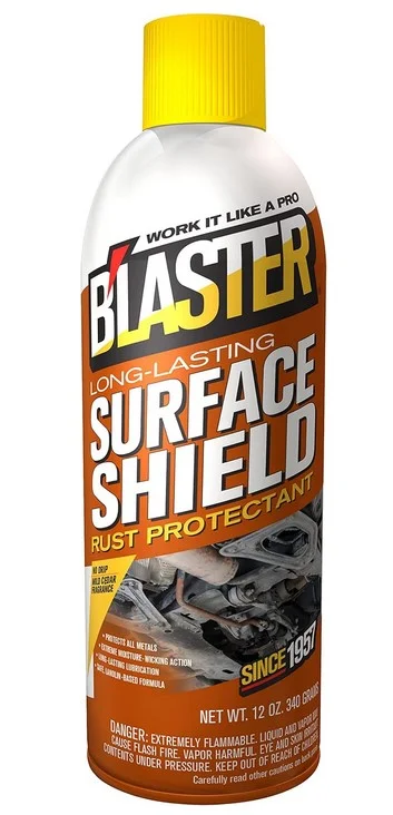

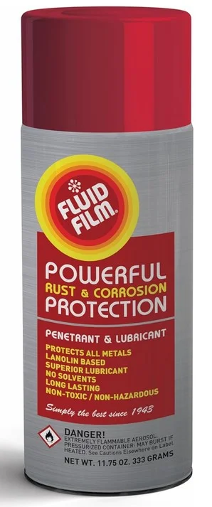

Living in the North East, I had 1 of my vehicles treated with undercoat from the dealership. They over sprayed in some areas. It made it a challenge to get to some of the bolts and nuts. Eventually a few years later most of it thinned out. After that experience I took it upon myself to treat all my vehicles with Fluid Film. Soon I'll be trying out another product called B'Laster. I try to apply the product before winter and late spring. Any thing is better than nothing.
