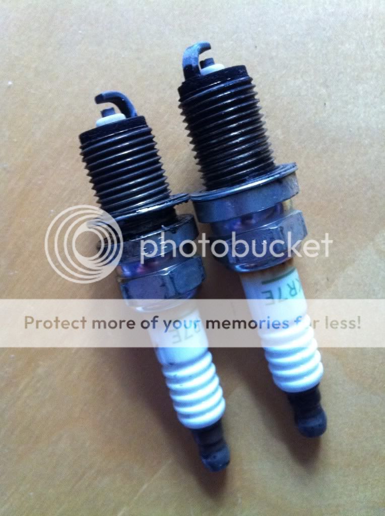

Here is a pic of my plugs that I just pulled. White tips and some carbon build up on the threads..don't think its bad enough to cause the bogging. Coil packs and wires are new also.. Do the plugs look as if the a/f is overly rich? I should probably get the flash done and stop procrastinating.
Are those copper plugs? My car runs better with the laser iridiums or whichever came stock in them. As for the reflash, my car has it and it still has pretty horrible hesitation.
My next question for you is why are you running BKR7E plugs?
I've ran 2 sets of the stock plugs NGK stock no 3271 and am now on my 5th set of copper NGK stock no 4291 plugs. (ZFR6F-11). Stock pcm, flashed and no horrible driveability issues.
I run 25psi with heat range 7 plugs which you totally don't need (ZFR7F)!! Don't think thats totally your problem but definately not helping.
What's your plug gap? Have you cleaned your MAF as suggested?
Could be wrong but I don't think a BK plug is the right choice for an FSDE-T. And he definitely does not need any 7 series plug driving like a granny on an unflashed MSP pcm.
I have NGK-ZFR6F-11 installed right now, after I pulled those in the pic. Those plugs were at a gap of .28 I believe. The current ones have a bit more gap and the car is running well so far. I have been out of town and just returned so I will take my car for a drive tomorrow and see if it acts up again. I'm hoping the plugs had something to do with the problem, but I am also doubtful. Do you guys think the flash is worth the money? It doesn't sound like a sure fix for hesitation.
Those are the right plugs but you need to gap them correctly. They are gapped for N/A cars.

I put about 80km's on my car today and it ran like new with no problems at all. This is after I changed the plugs to the proper heat range. I would like to note that a veteran mechanic at a local garage and also Mazda techs at a local Mazda dealer could not figure out that this was the fix for my problem. It seems as if there isn't a CEL to scream the problem at most mechanics than they won't know what to do.. Anyways, I would just like people to know that the proper spark plug for your boost level is not only a suggestion, it is a necessity.

Actually the main problem with the OP is that he was running colder heat range High boost plugs at 7psi like I run at 25psi and mostly because they were gapped at .044 or higher as they appear in the pics on page 2.
