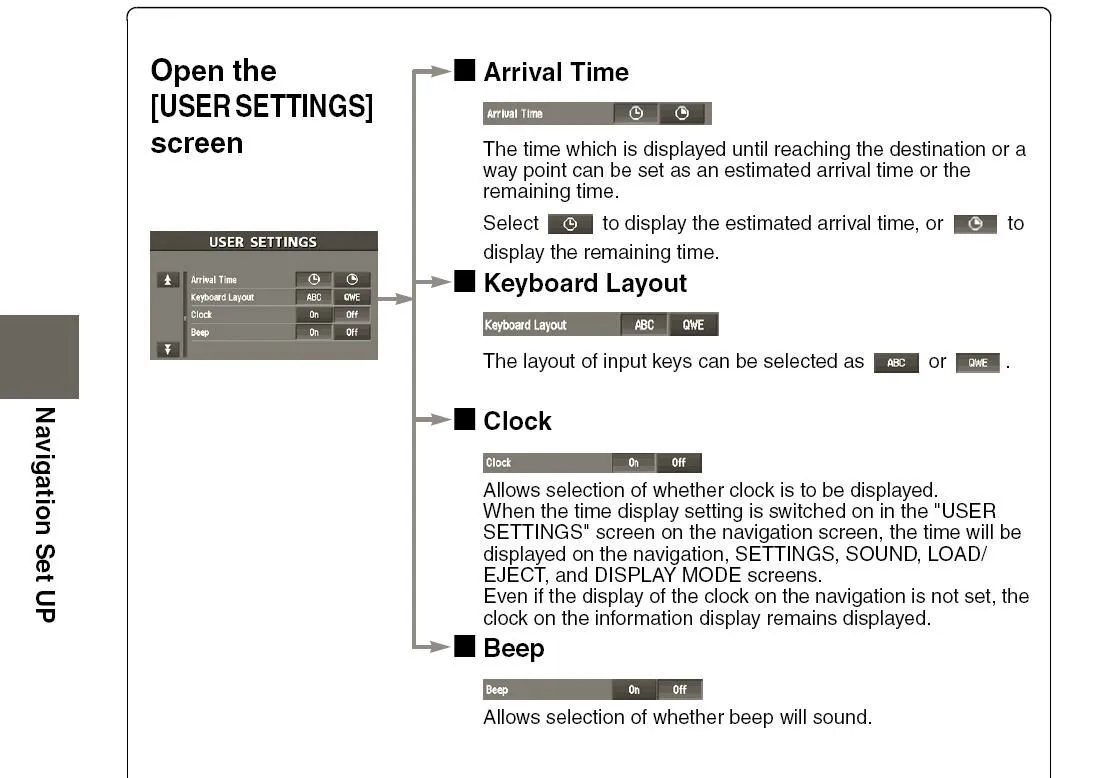

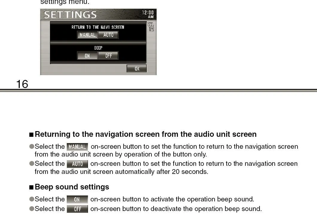

OK, I have the navigation system and those instructions don't apply I guess. I looked in the nav booklet and didn't find any instructions on adjusting the "beep" volume there. Am I missing it?
See Page 17 and 46 of the '07 Navigation manual or the attachements.
Thanks for the scans. The '08 manual is different. This silences the beep on the navigation menu but not the steering wheel controls.
