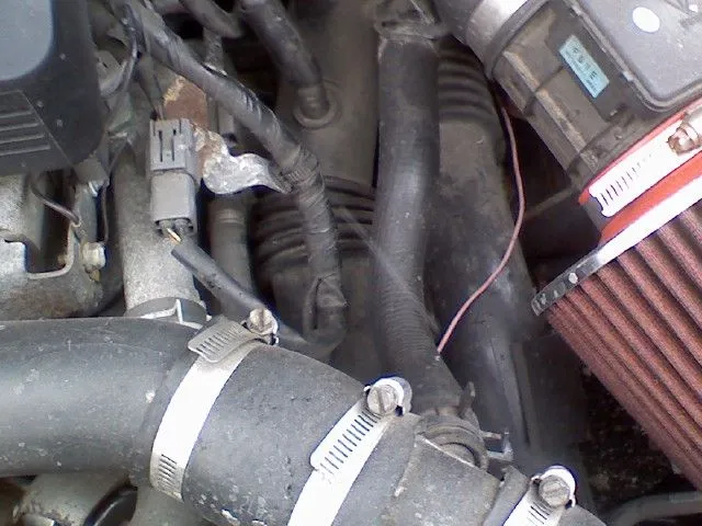

These two pics were just taken. This is how I bought the car. I tried to get the best view of the hose where the BPV should be. And yes I do have a boost gauge and it's reading 7psi.

wow that is messed... because you are making pressure and pushing it into the IC not an open pipe to the intake... but that pipe... not so much.
yeah, not a good set up at all. I wonder if whoever was running a DIY pipe there with a BOV on it and just threw it back together like that when they sold it so they could hold onto that BOV for thier SR20 primered 240?

Yea I had the feeling that the kid that traded it in took off a bunch of things, I mean it looks way to butchered up under the hood. It had 2 T-fittings in that one line and i recently replaced it with a solid piece when I installed my new wastegate actuator.
