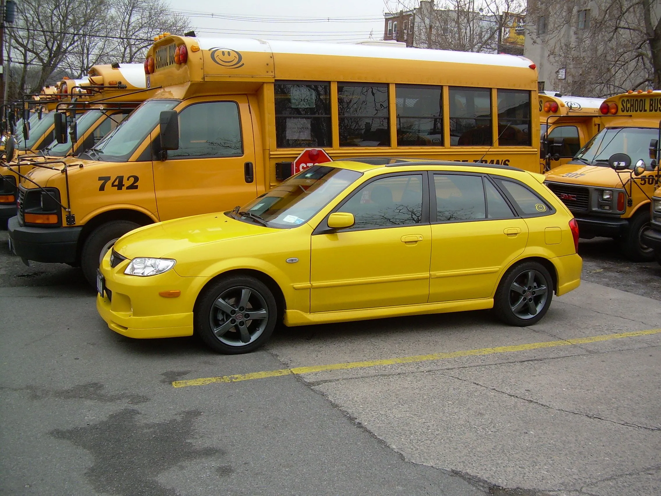

correct me if I'm wrong but I believe they're polished. I painted mine with duplicolor wheel paint. there are tons of how-to's around. run a search...
before:
after:
yes, just a different process. IIRC polished wheels were an option on the p5. In short, yes it's possible to paint your stock wheels. DO IT!
I will! ....I really like the look of a chrome outline...so would I just tape off a lip on the outline of the wheel to do this, or just go ahead and paint all black?
hmmmm I would go all or nothing. but that's just me. if anything, you can try it out and if you don't like it just paint it all.

i used the duplicolor high heat engine paint because i figured it would hold up longer and it does
i sanded down the chrome wheels until they looked like the regular polished ones when they were dry
then i used primer, the high heat paint and then clear coat
the wheels are prob. gonna look dull at first, just wait a week or so and wash them and put a little wax or polish on them, they'll shine and look alot better
The more coats of paint the better. Just let each coat dry evenly.
Then when you clear coat it (a few coats of it) it will look great.
