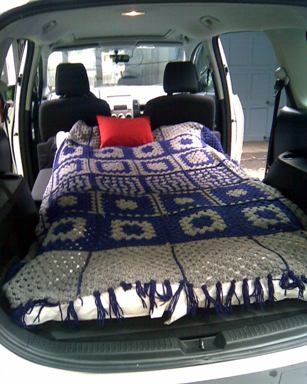

I know Mazda5 is not a RV, but anyone slept in the Mazda 5 with a mattress?
Any other tip and tricks have you learned about going camping with Mazda 5?
Nice base for a mattress.
1/2" thick cardboard from shipping containers here at work:

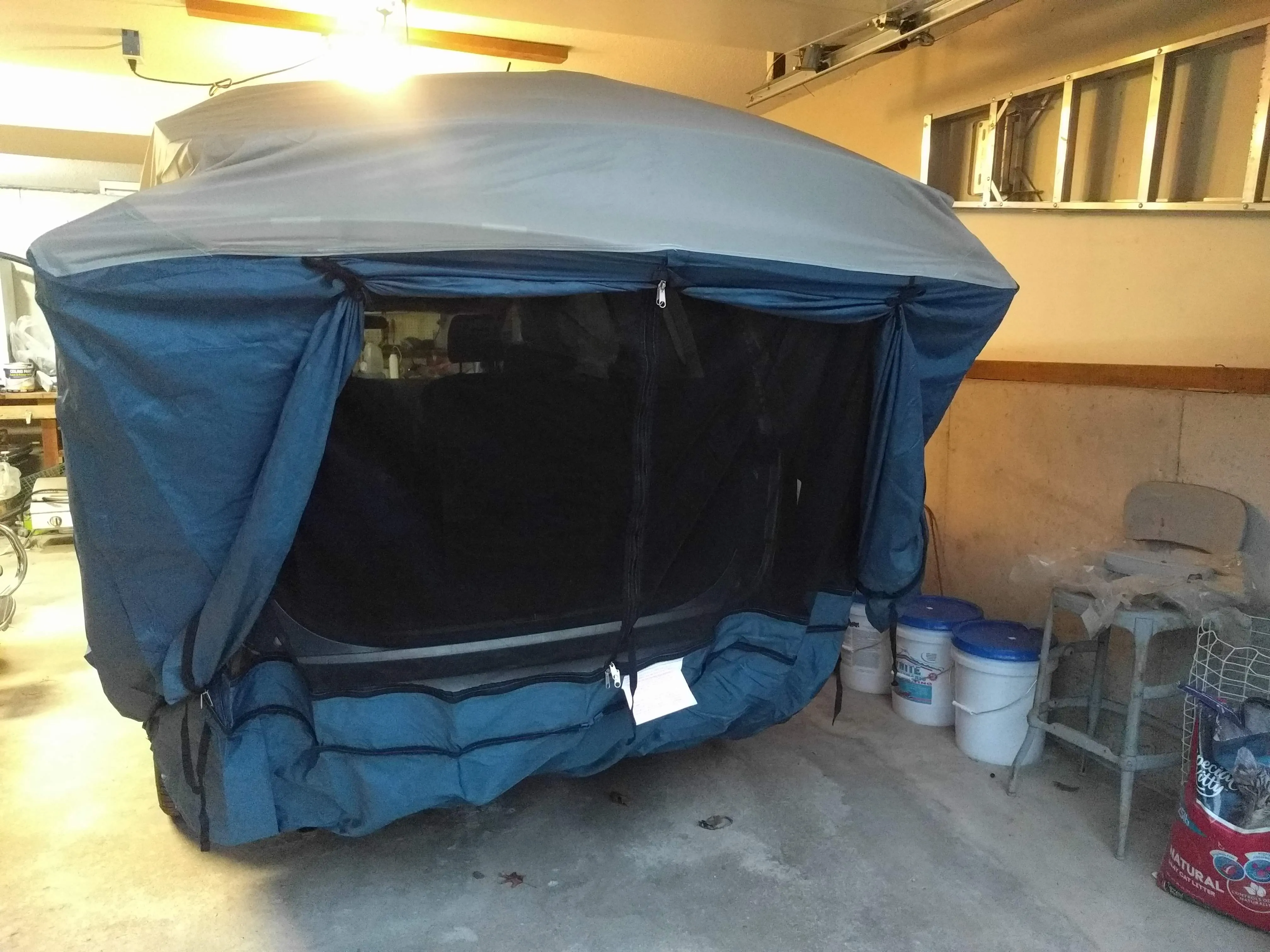

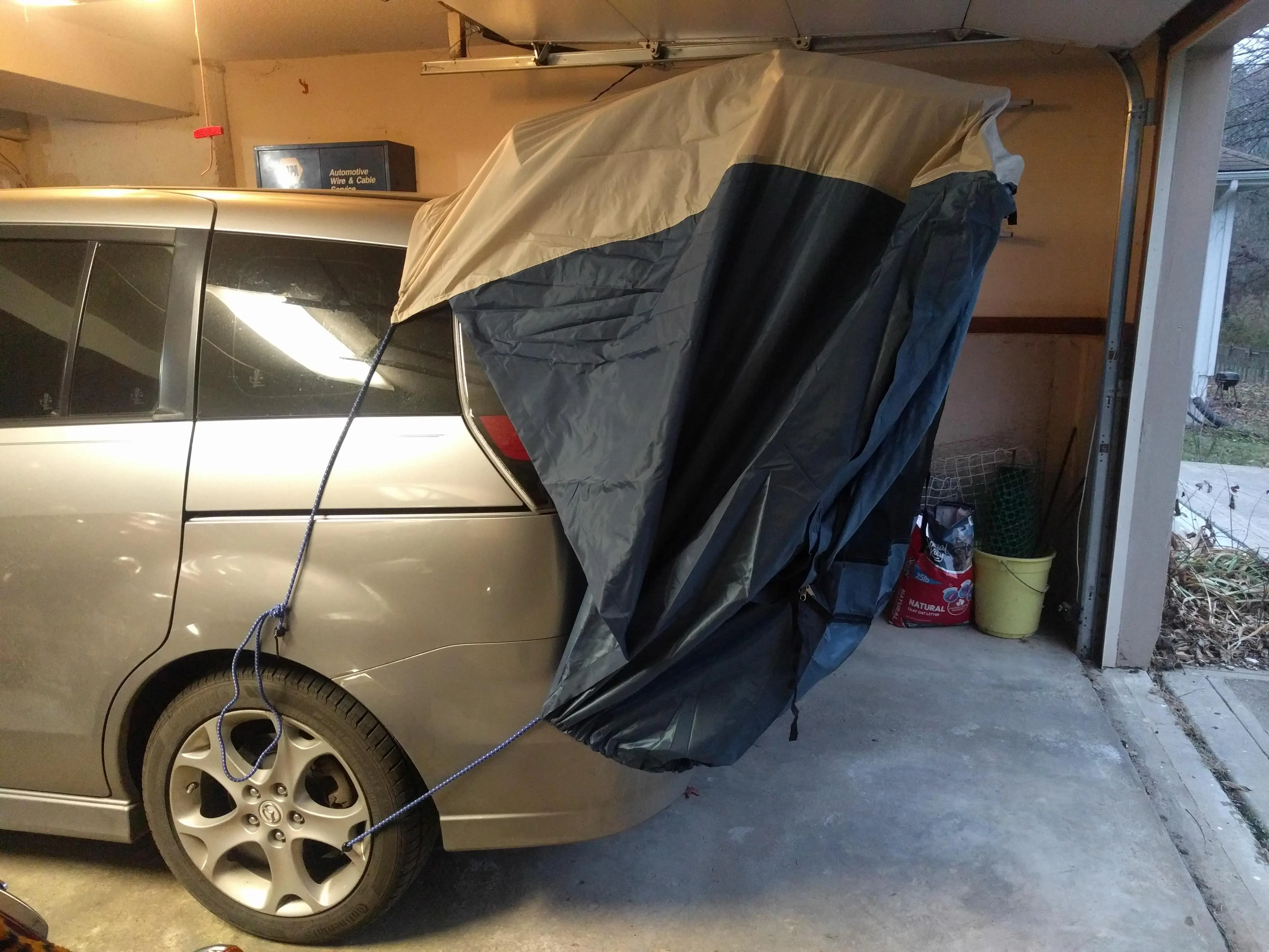

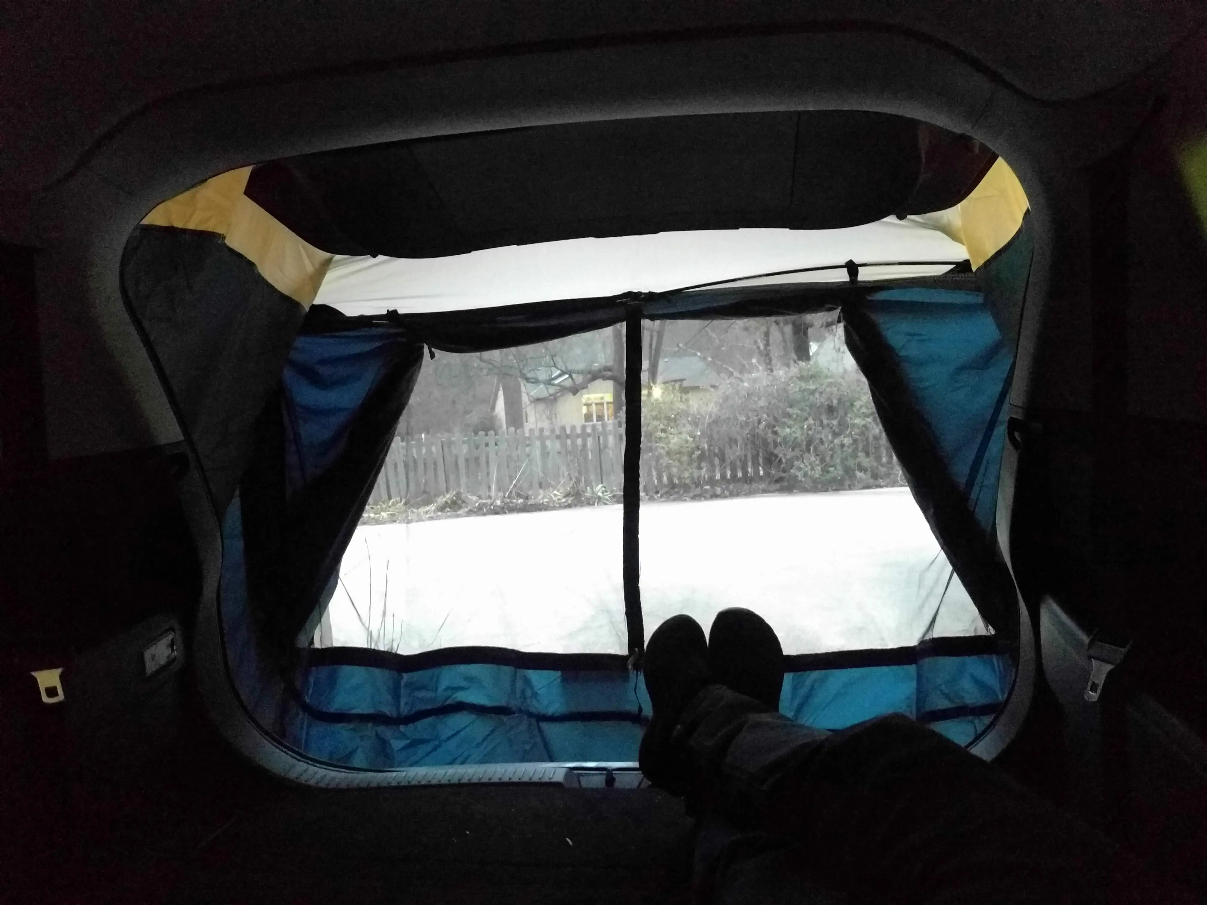

FedEx just dropped off my new SUV/minivan "tent" - supposed to fit the M5 but it's also universal so it's not gonna fit nice without some modifications - I've shortened the bungee cords considerably for starters, and strong magnets should help seal it a bit better. I'm not sure this'll be useful in the rain, but at least on nice nights it'll help with ventilation. I'd like to find the "hatch open" switch so the dash light doesn't stay on all night, but maybe one night won't make much difference (one door or another has been left open overnight before - (thumb) thanks kids lol!)
Cold front came through today so no test of it for a while other than in the garage, but I'm looking forward to warmer weather and a chance to give it a try!
Update re: the "door open" light when the hatch is open for tent use - found advice to push a carabiner into the latch on the door and the light will turn off - and it works! You do have to use the door handle to remove the carabiner or the door won't close, and I suppose if safety or need for a quick door-shut is an issue, this might not be the thing to do. Would really like to have a way to open the hatch from the inside, but I'm not finding information on that anywhere. Ah well. :}
Well if the position of the mechanical switch is sending a signal to the dash to say the door is open you could theoretically put a manual switch on the inside of the door panel to give you a cutoff for that signal to be sent. Would need to make sure you had access to that switch from the inside just in case you left it off..... though you have a 1st gen, so it should have a manual door release vs. the electronic release in the 2nd gen.
