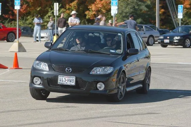

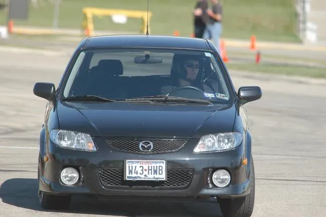

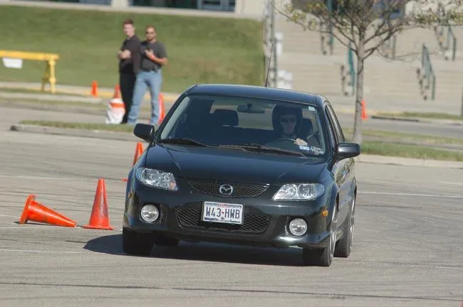

I might still be overdriving I'm not trying to say I'm an expert. Heres some pictures of whats happening. You can see not an extreme radius turn and the car isn't visibly pushing, just following the path of the front wheels.
The last picture shows the tires unloaded so you can see how the sidewalls angle in away from the wheels like I was talkin bout before.
Doesn't seem that bad to me...I've seen photos (on other cars) that show far worse.
