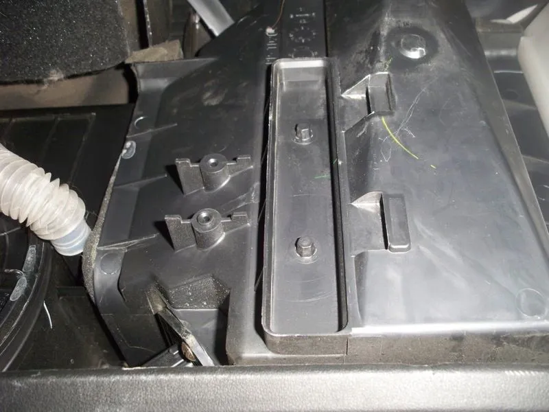

I too have been meaning to take a look at this. Did so at lunch today. Looks like USDM P5s *do* have a spot for it. You'd need to bust out some knockouts, and source the bracket and filters... Pic attached.

I've been googling around trying to find a replacement bracket and filter (in the US) and don't see anything. I did find this site where a guy retrofitted a subie, and I think the procedure would be identical for us:
http://www.subiegal.com/thecars/imprezamain/subarutuning/cabinfilter/subarucabinfilter.htm
All we really need is the part number for that bracket and filter. I bet with the part number, and dealer (or online part supplier) could probably source it.
CH555- any chance you could check that bracket for a part number?
Thanks wildo, that's some good research there. I'm guessing we need the dimensions of the cabin filter from ch555's car so we can cross reference that size for another part that will fit.
