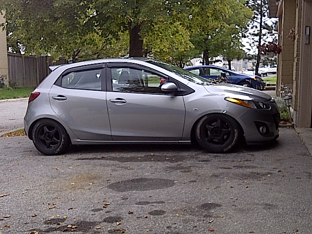

Most of the time it's just not low enough. My oilpan is like maybe 3.5" off the ground.. need to go lower :P
Btw, my 1 gripe about the KSports, the rears just do not go low enough. I'm running out of threaded room on the rear shocks, and it's still not as low as my fronts.. and this is even without the rear spring perches to get that bit extra of low. I'm gonna adjust until I have no more room to go, and then if I wanna go lower, I'm either gonna have to figure out some custom stuff on the shock, get KSport/Fonty to talk to them, or cut a coil off my rear spring.
Sorry this is a little off topic, but could have relevance at the same time, do you have any current pics of your height Greensleeper? Maybe even pics of the literal coils on the car?
No I don't have a true 'lateral' picture yet, but you can look at those I posted in the 'Dropped' thread:
I want to tuck wheels I hope I find some that go super low, might just need airbags.
CRG, I don't know how you can manage to drive around with the front slammed like that! My front end is a touche lower than my rear, and let me tell you that the CS skidplate is more than welcome, I scraped it more than once on our beautifull Qubec roads.
