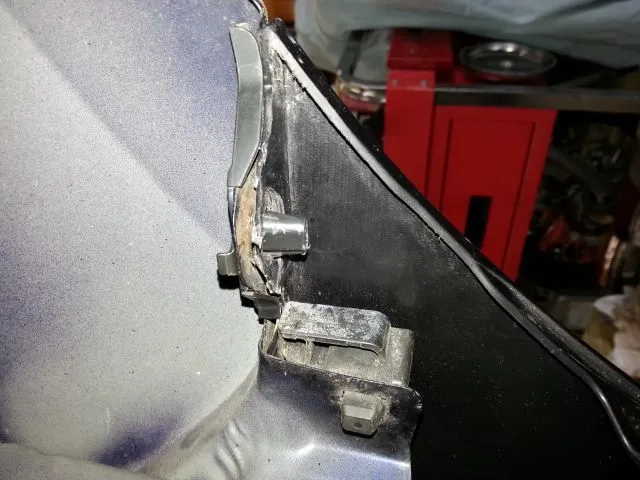

Hi, I need to see how the bumper cover is mounted on the the fender. This is the area in the wheel well. Anyone have a picture or something that I can see what parts are needed and how to assemble. Thanks in advance, bigfish246.
there are three clips on the bumper cover which slide into holes along the seam where it meets the fender. Then there's a single bolt in the upper rear corner of the bumper cover which goes straight up (looks like you have that spot pictured there). AFAIK the bolt is the same as the ones which hold the lower engine cover to the bottom of the bumper cover. That's all that holds it along the fender.
