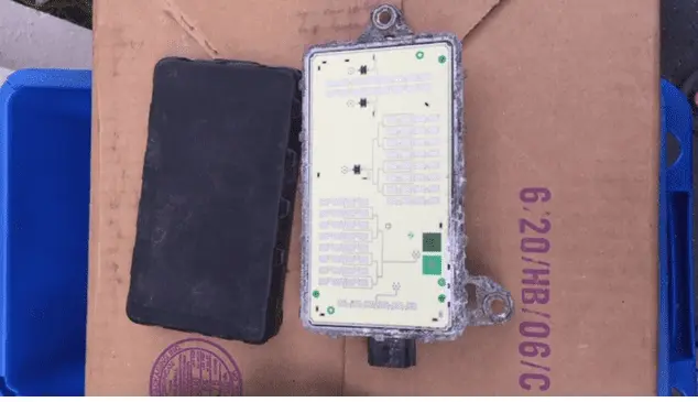

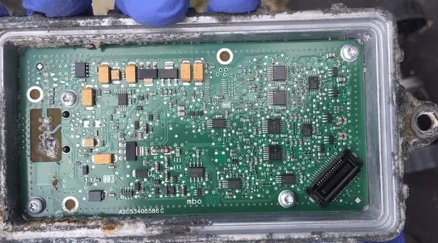

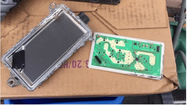

I have same issue with 11 cx9 gt. BSM light was blinking on dashboard. I have run the diagnostic test for left and right BSM on computer. The left was working fine and computer gave me error code for right handside. it was showing short. I tried to reset a few time. it was working fine. I washed the vehicle and inside of the fenders too. I drove the vehicle without any issue. I parked my car for 2 days and checked the car. light was blinking on the mirror like something was touching and grounding. I removed the modules.
I havent touch them about 6 months and decided to open the inside. of course lots of corrosion. I was planning to clean them then test but board does not come out without removing the socket. the socket looks like hot pressed or glued inside. I wanted to share the picture with you if anybody is interested to repair own modules.
gently pry the plastic covers pins with flat head screw driver then open it. Also check the contact on the board.
UPDATE: You can remove the board with soldering machine. when you remove the all of screws on the board, 2x 4 pins (left hand side on picture #3) holds it. remove them clean the board and housing, solder it again and seal the entire module. I hope it works for someone.

Permanent solution: Since I shared the post above, I bought 2 of used BSM module in Junkyard with the same part number. They came from 2013 cx9. Before install them, I tested with forscan and no error message. they works great.
I unplugged the modules and made a little modification. I squeezed silicone between plastic cover and housing like a seal. also between socket and housing too. I wrapped the socket with electric tape and made it solid.
there is no issue since I installed it and no more water damage.
Total cost: $65 x 2 module + small tube of silicone + electric tape
Labor: Free
Total time: less than 1hr.
