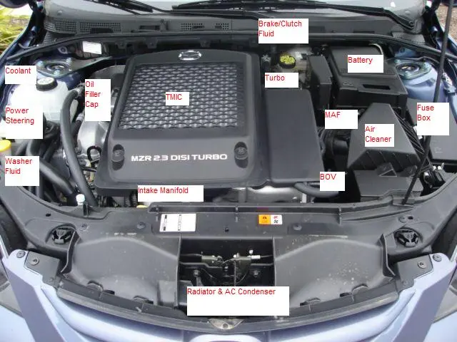

I just ordered a Forge BPV and was wondering where the stock BPV is located. Can anyone describe its location?
Look for the BOV label in the picture.
