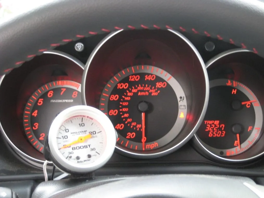

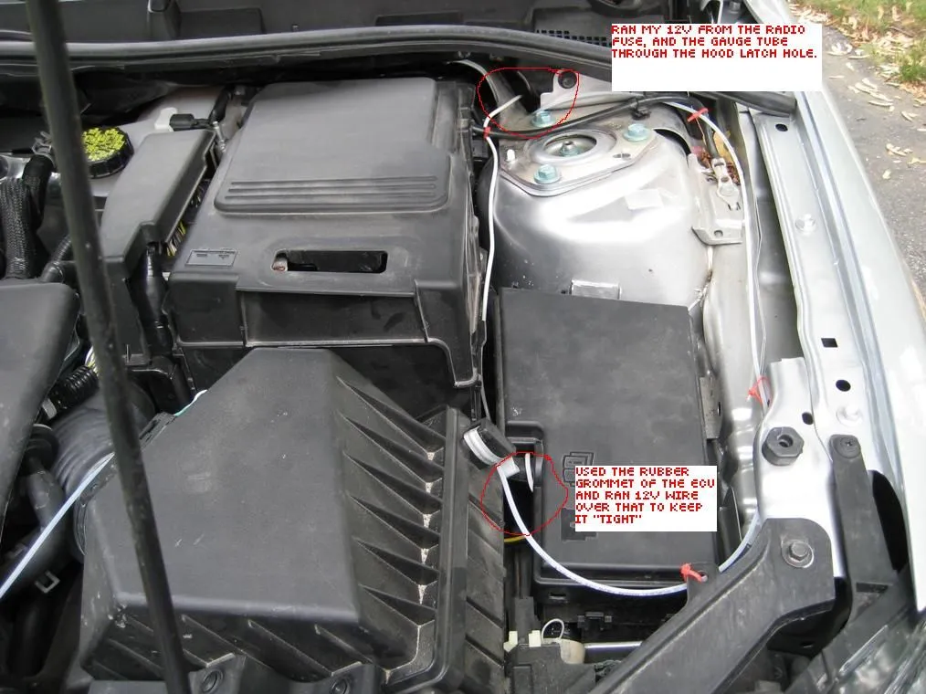

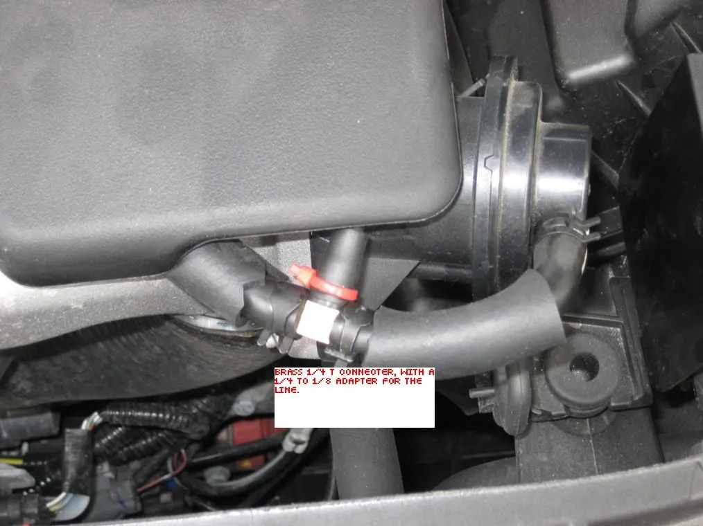

Quick noobie question as i just put my gauge ( Auto Meter / 2 1/16 30 PSI Boost Mechanical Vacuum Gauge) on. Completely stock set up with no other mods done yet.
what is normal vacuum that most of you all have, as i am have 20 in/Hg at start up and between 15-20 in/Hg during normal driving.
Also for Boost, 1-2 gears i got about 10 PSI, and 3rd+ gears i was running about 14 / 14.5 .
Is that normal for what most of you have?

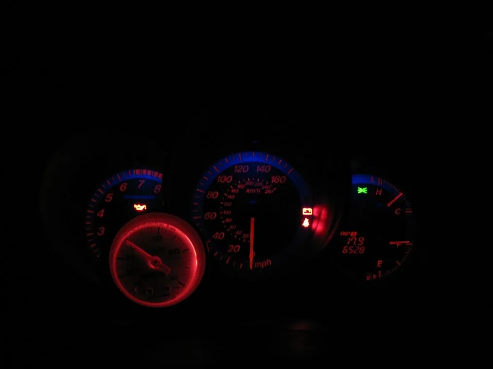

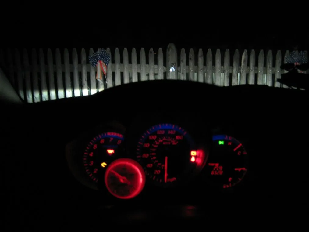

Night time lighting.

i see about 18-19 at idle, when i was in la(closer to sea level then lancaster, both in california) i saw 21-22. so i would guess your ok.
