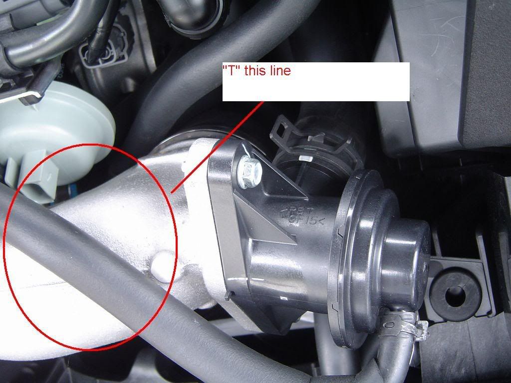

post a picture. I have a feeling you tapped the wrong line.

here.
Dont wory..I hook every thing like its suppose to be..Tee in the BOV hose..
restrictor fitting side to gauge hose........but boost spakes at 18 psi..
