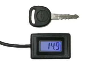

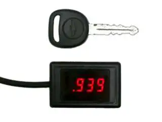

DPSpeed said:
I ordered this one Boost Gauge, I wanted something small and I could put anywhere. I'll post after I have it installed.
Wow..... Those gauges look great! The MS6 needs a boost gauge & should have come stock. (glare)
Wouldn't an analog gauge be better to check the boost though? (confused) (confused)
