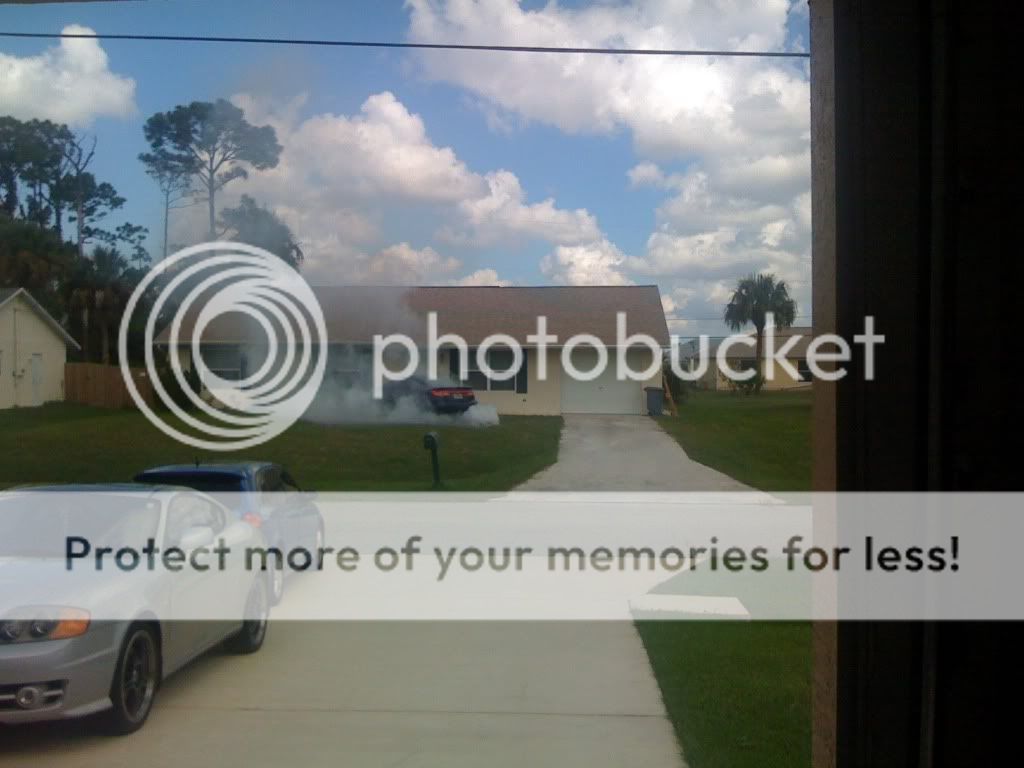

random insert
but, smoking as bad as the guy across the street from me? Just snapped this pic 30 minutes ago
thats some sea-foam..or atleast i hope so..this thread will be moved im sure but to the OP, seriously u added 2 quarts of oil..really?? did u check the dipstick first and see if u were even low..even if u were u only add a half a quart at a time and keep checking until its ideal, u just dont go throwing 2 quarts of oil into the car.. u should'nt own a car if u did that..period.. and to top it all off u put the wrong oil in the car, u should atleast be using 5w-30 or 5w-40 if ur having the smoking issue.. drain out the old oil..get a new filter and fill the car with 5 1/2 -- 6 quarts of the correct oil and call it a day.
